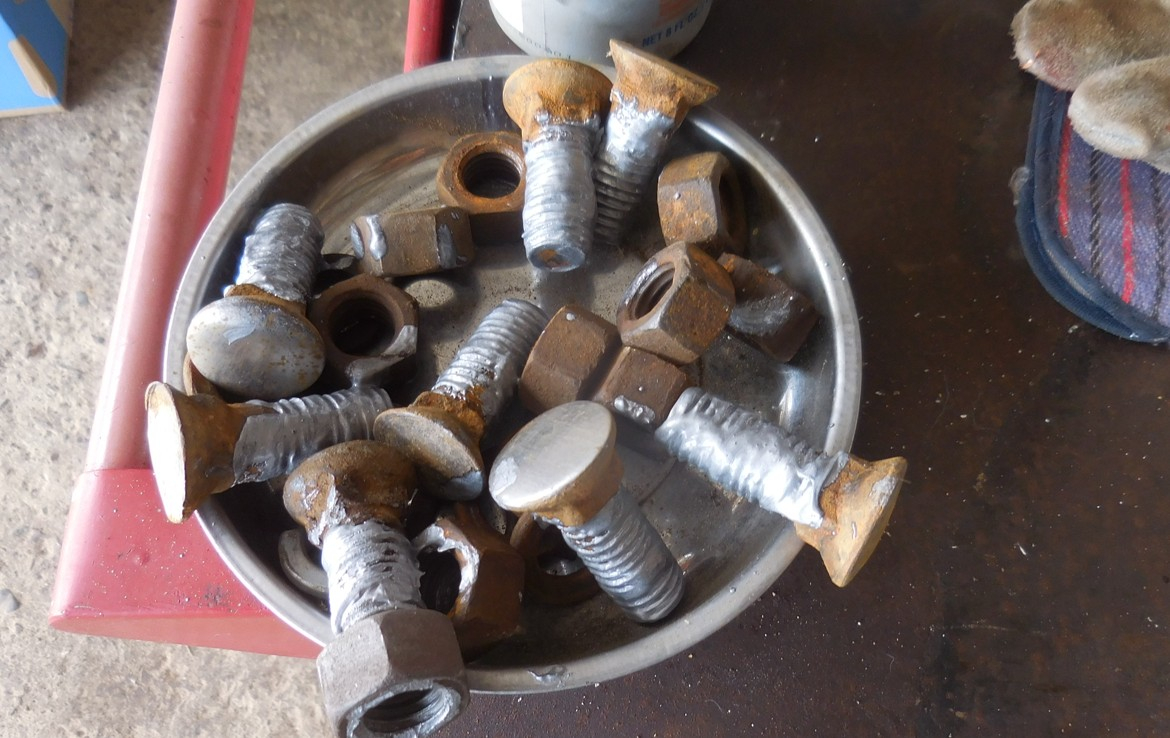

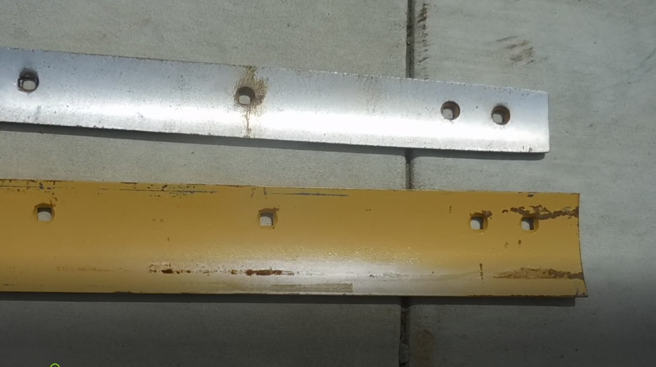

I had this 3-point grader blade for more than 10 years, purchased used one from a local area.
It has been served so well but time to replace the cutting edge due to the dulled
I already flipped over the edge when purchased.
I don't even know what brand name or which company made the blade.
I have researched for a long time about this blade cutting edge with blade hole size.
Fortunately, I found the right cutting edge part number which is 9W2297CD(CD means cente
r drill for the bolt holes.)
The price between the $60 - 150 but truck freight is more than $150 because the weight of the cutting edge is 54lb
But in the research the cutting edge is for caterpillar small grader
So, I contacted the local caterpillar dealer and they have it but not center drill other than that everything is exactly matched.
The price is only $54.00.
The installation is so easy and it works like new again.
Hope this video helps people who need to replace a cutting edge on the 3 point blade.
