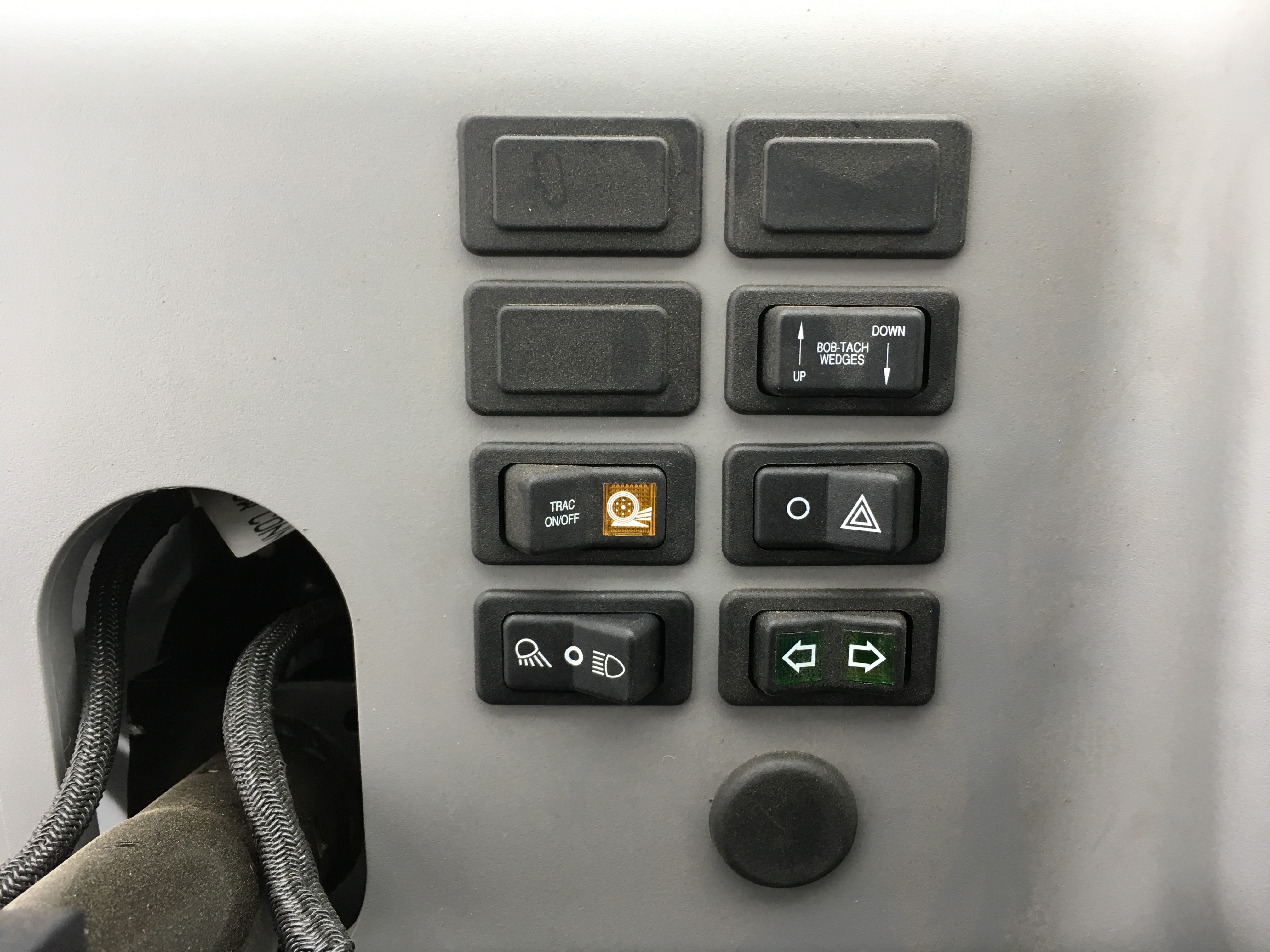

Was able to look at a Toolcat with traction control. The button is on the dash panel. In the attached picture it is the button with the amber light. Just posting to close the loop and so others wondering where it is can see.
