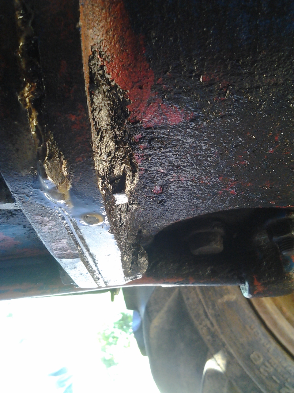

More concerning are the following. The loader tank is make up of the frame of the loader. I have fluid leaking from one of the welds and a nearby crack. I'm not sure I'm up to the technical ability to grind this and re-weld it. I only have a miller thunderbolt stick welder, and I'm still developing proficiency. It would be an overhead weld as well. Anyone have any experience with a sealant I could put on it? Other thoughts? Here is a picture. 20140717_131716.jpg

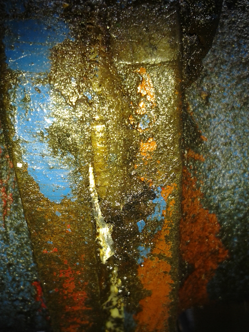

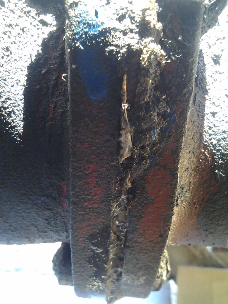

The other leak is kind of odd. It was leaking water from the flange between the rear and center sections of the tractor. This am it was nearly pure water. By this afternoon it is cloudy, like it is a mixture of water and utf. Is this supposed to have a gasket between the sections? There seems to be some white sealant on there. Outside of splitting the sections (which I don't have the time or inclination to do at the moment) any thoughts on sealing this. Here are picts. 20140717_131626.jpg20140717_131405.jpg20140717_131608.jpg

there are gaskets between the trans and center section.. yours looks pretty gunked up. prev owner may have tried some sort of caulk ??
loader sumps are non pressurized. drain it and spray clean as a whistle with carb cleaner.
at that point i'd leave cap off and braze or weld..
if you can't do that.. then try jbweld.. it's one of the few places i MIGHT try it..

Yep a bit of white calk looking stuff. I cleaned it with a wire brush then with carb cleaner. Then put on some permatex black rtv. All this after draining some really watery fluid. Hopefully that'll hold till winter.
The diff looked to be way over full. I pulled out almost 30 quarts and it still came pouring out of the check plug. Its all good now.
