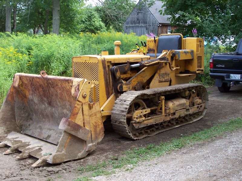

I had a similar dilema this past fall.
I have 10 acres and needed to clear some of it. My Kubota B2710 was not really suited for the job. So what did I do? I could have spent $5000-7000 and contracted out the job but instead I spent just under $5000 and bought a mid-60's dozer and kept the Kubota. When I am done I can always sell the dozer for what I got invested.
You might want to look at doing the same. I believe that your tractor is much more versitle than a small tracked unit and once your dozing jobs are done you will be longing for the tractor back.

<font color="blue">...instead I spent just under $5000 and bought a mid-60's dozer </font>
I'd be a little hesitant to buy something like that unless I knew someone who knows something about dozers who could come along and do an inspection for me. As I've read on this forum, dozers in this price range can be not much more than scrap metal - very expensive to repair. Having said that, looks like you made a good buying decision.
<font color="blue"> I believe that your tractor is much more versitle than a small tracked unit and once your dozing jobs are done you will be longing for the tractor back.
</font>
You may be right for most folks. But, for what I anticipate doing with the tractor, I'm not sure. Bucket and pallet forks use - loader beats tractor if for no other reason than increased lift capacity. The NH is limited to about 750 lbs. Grapple - loader beats NH because lift capacity and I'd have to add hydraulic lines to the NH. Auger - loader beats NH as auger would be up front (no neck twisting) and has down pressure. Bush Hogging - loader beats NH as cutter is up front - don't have to drive over brush before cutting and better visibility. Gravel drive maintenance - don't know. I do have a box blade for the NH but have barely used it. Can't comment on the track loader for this task. Backhoe work - NH may have an advantage simply because I have one and wouldn't buy one for a loader. Ease of attachment change - overall the track loader would win hands down over 3PH. The point I'm making is that for most folks, a conventional CUT would make more sense for everyday use. But, for me, a skidsteer or track loader is looking pretty attractive.

</font><font color="blue" class="small">( I'd be a little hesitant to buy something like that unless I knew someone who knows something about dozers who could come along and do an inspection for me. As I've read on this forum, dozers in this price range can be not much more than scrap metal - very expensive to repair. Having said that, looks like you made a good buying decision.)</font>
You're right, they can be simply scrap metal. However this one is not and was well maintained and has about a 75% undercarriage. There are still plenty of parts around for IH TD's. All I've done is replace a few hoses and have the hydraulic pump and spool valve rebuilt. No big deal since I have a friend who does that for a living.
Looking at what you are going to do, I would trade up to a 50-75 or so HP utility (not CUT) tractor and still buy a used small dozer for the big stuff. I think you will be better off all the way around, both financially and productivity wise.
