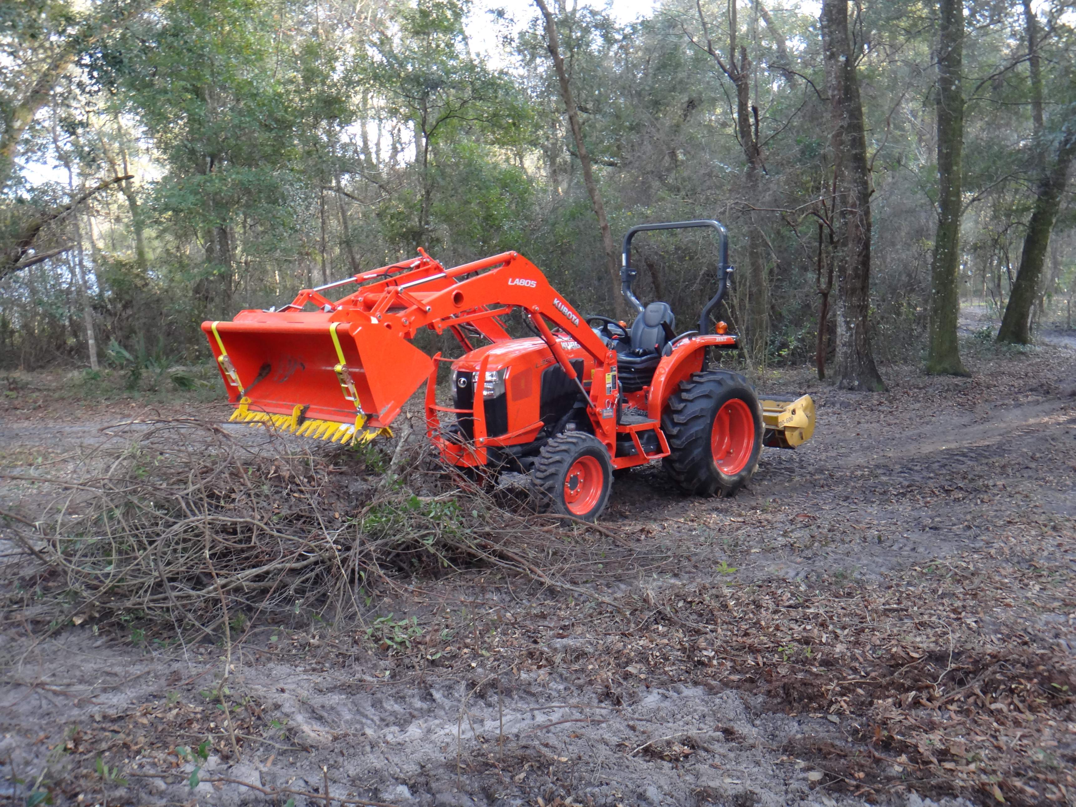

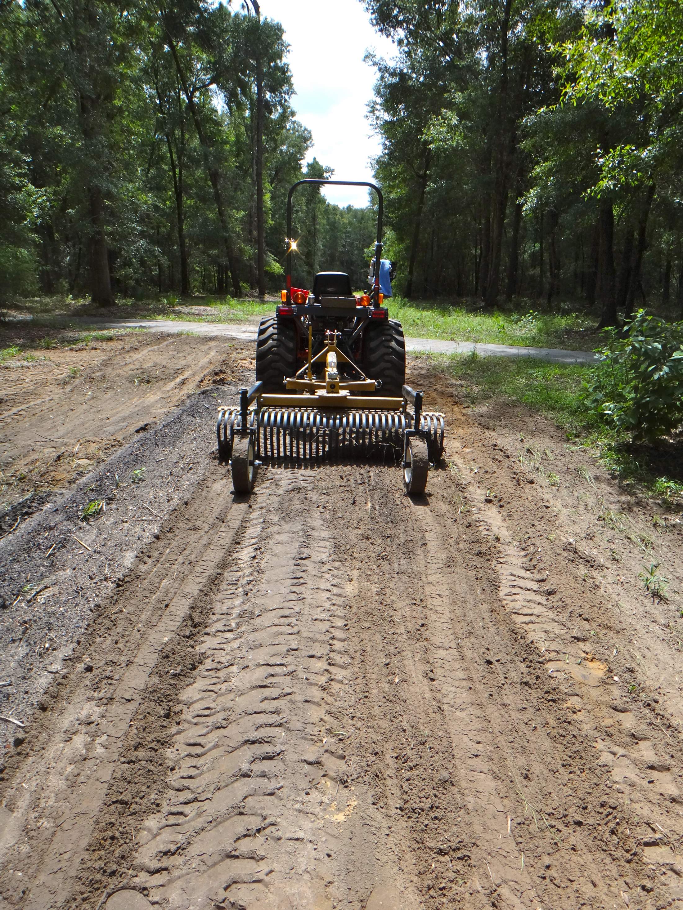

For debris cleanup and piling, a Ratchet Rake is multiples more effective than a Landscape Rake.
Ratchet Rake spends three times more hours attached to the bucket than the Landscape Rake spends mounted on the Three Point Hitch.
I have both.

jeff, I have a root grapple on the front of mine that I pile and pick up the size of stuff you have in your pics. I need something a little finer that isn't going to scrape the ground bare. I can pile and pick up stuff with the grapple to what would be considered "rake clean" then however, theres still a lot of stuff that horses and mowers don't get along with leftover. Where you at? You wanna sell your rake?
