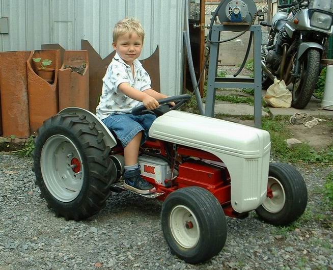

Here's the tractor mentioned in the Daddy /backhoe thread. I made this one from a 24 volt handicap scooter 24volt- a great sophisticated powertain for ride-on toys. Front end and steering are modified riding lawn mower and the bodywork is vacuumformed plastic over homemade wooden molds. The whole thing took about 6 months spare time to develop and build. The molds took most of that time. The boy likes it but I'm having as much fun making things as he is!

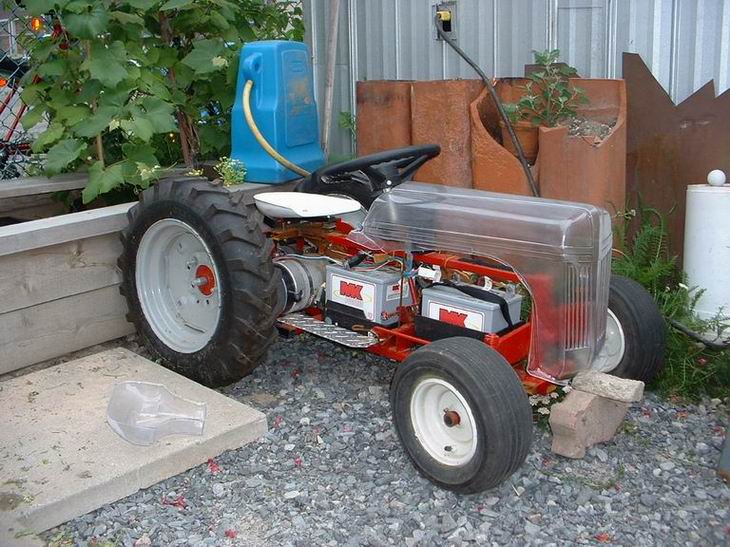

another pic- this time before painting the plastic

Thanks for the compliments! As for building it, its mostly a recycling project and I try never to throw things out. It started with finding an old twowheel tractor (rototiller thingy) at a junkyard. The 12" tractor tires just looked ideal for a kids toy. Gas engines just seemed too much for a three yr old. Used handicap scooters are cheap or free- this one was saved from a hospital dumpster.
The best thing is the boy wants to help out whenever I'm working. He'll be grown up before he realises that he's been working since before he could remember! Hopefully the farm will be in his blood.
Ger
