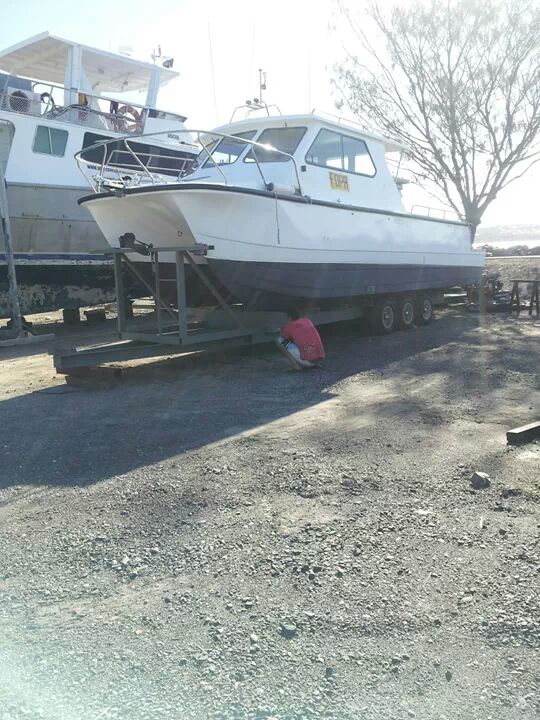

ok that sounds really good yea the tractor would be really handy around our small acerage as well the boat is pretty large for towing ect, commercial fishing is part off my yearly income the boat is set up to stay out at sea for 4 days or so,cheers

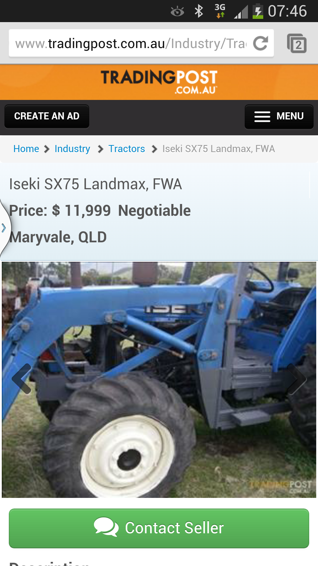

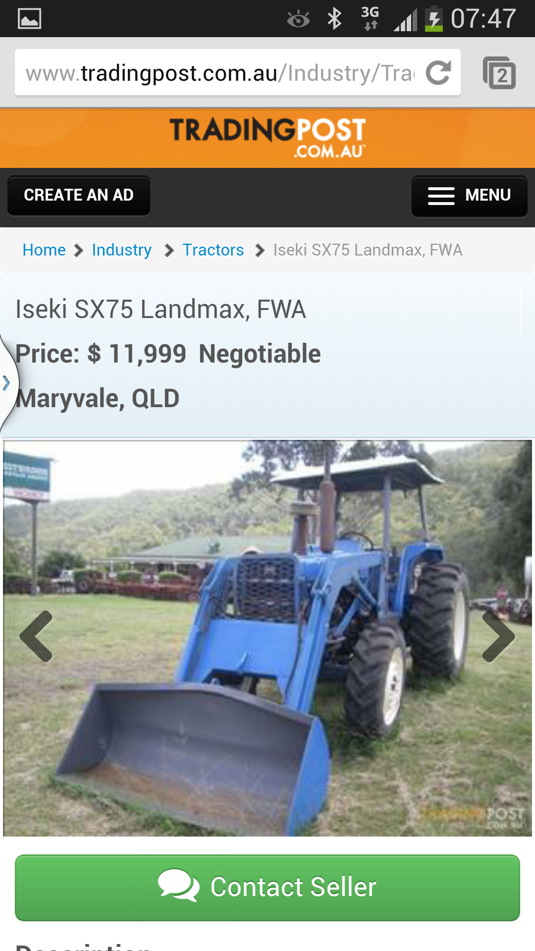

#9
Screenshot_2014-01-05-07-46-53.pngScreenshot_2014-01-05-07-46-53.pngSome pics of the tractor all looks like it may be missing some motor cover panels.
