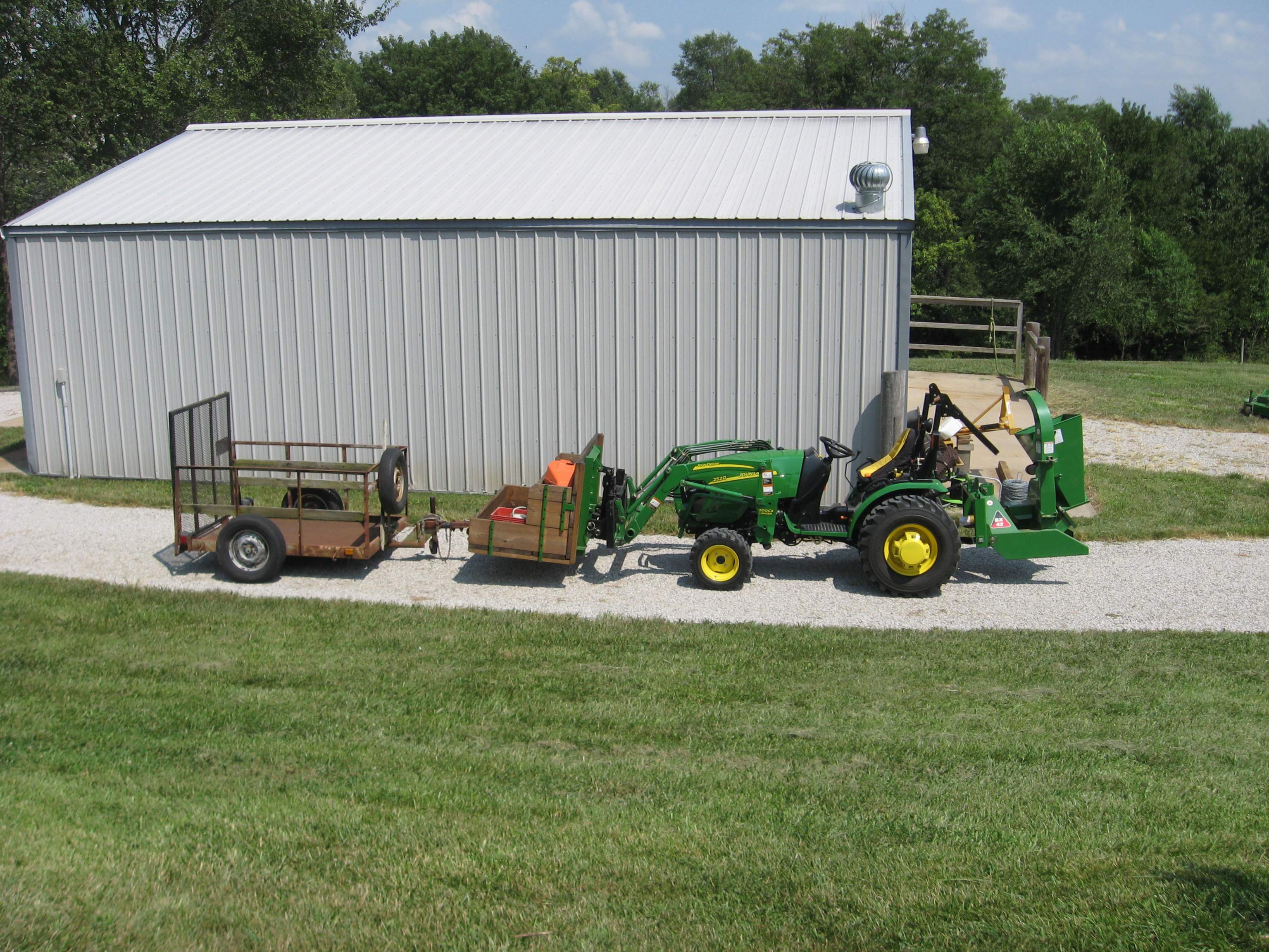

I use my front mounted quick hitch with a "three-point" trailer hitch, or a front-mounted carryall (that also has a receiver on it) to pull a trailer when I have something else on the back. This may not be the best if you have a long way to go...

And you don't have to drive backwards!!
JB
   / Towing trailer with Backhoe? #8
Never have figured out this picture posting, but my hoe (JD47?) has a link that curls the bucket. I built it up a bit with 3" channel and added a 2.5x2.5 tube to the top. I then made a special "draw bar" that had a bend in it to allow it to clear the frame of the hoe when I "dumped" the bucket.
To use it I curl the bucket which leaves the ball sticking out to the rear....
