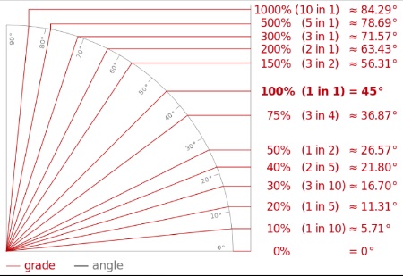

Anyway, you said you have 12% grade? Are you certain that's the slope angle? How far will you have to travel that way? Is this all over your place, or only a small portion of your travel path will be sloped? Are you willing to crawl along at a slow speed during this time? Can you go straight up or straight down this slope? If you have to side hill it, that brings a whole separate set of conditions to worry about.
Slope angle chart:
A true 12% slope really isn't that steep when putting around at slow speed on a tractor. We're not talking 18 wheelers at 80 mph going down The Gauntlet here.
Depending on your circumstances, I'd maybe try it. Put the tractor in 4wd, L range or *maybe* M range on the hydro and crawl along. If you're in 4wd, you have braking traction at all 4 wheels instead of just 2. Use your diff lock on the slope too. Also wait for dry soil conditions, don't need to add mud or wet grass to the equation.
