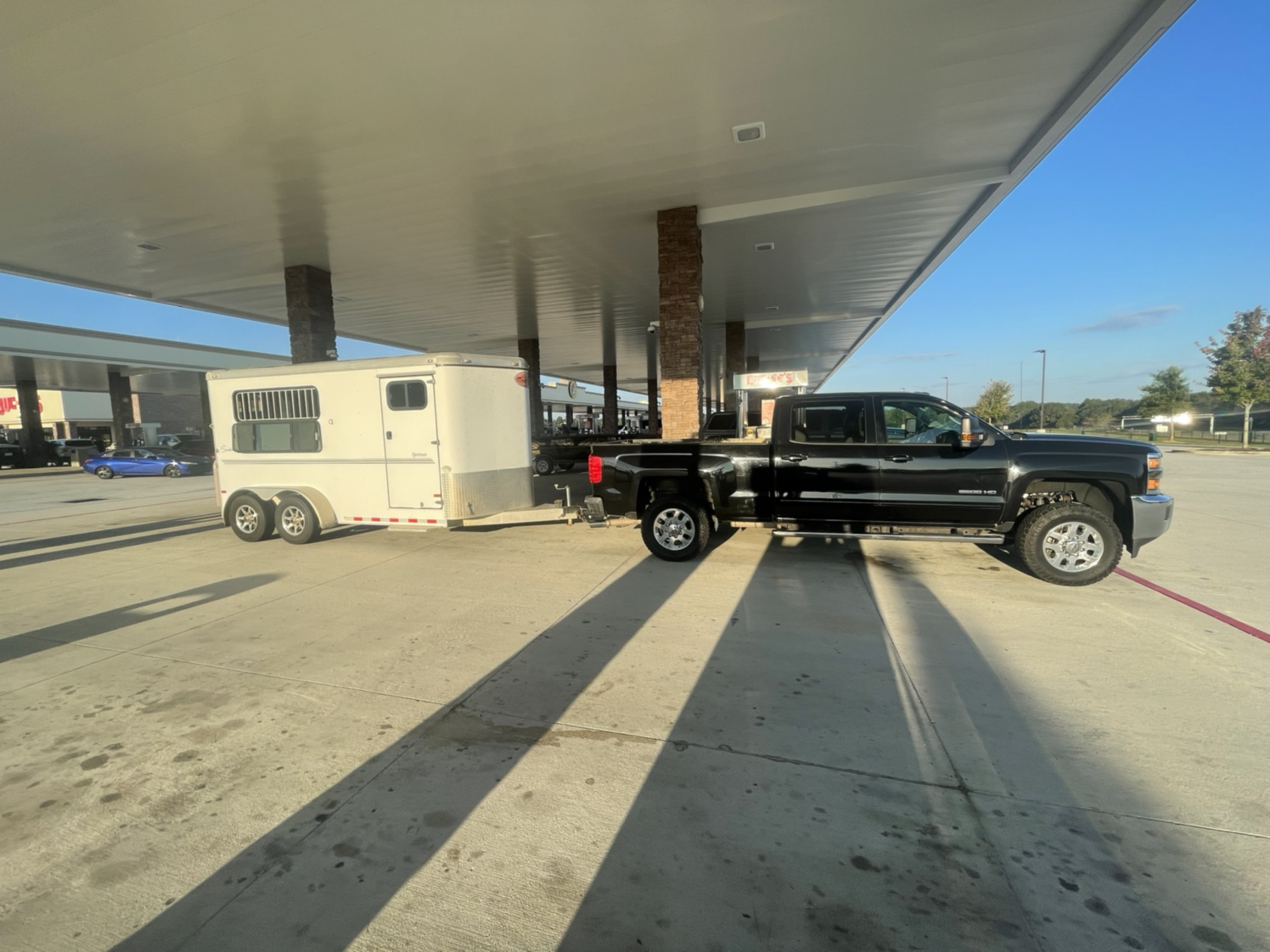

As mentioned in a previous post, we recently purchased a 2015 Chevy 2500 with the 6.0 gas. We currently pull a 3 horse bumper pull trailer when fully loaded comes it just under 7k lbs. ( pic attached).
We have an opportunity to upgrade to a 3 horse gooseneck with small living quarters. We averaged almost 9 mpg on our tow this week with some hilly driving at 70-72 mph. How do these trucks handle gooseneck towing? The only experience we have with gooseneck towing was with our Ram with a Cummins.

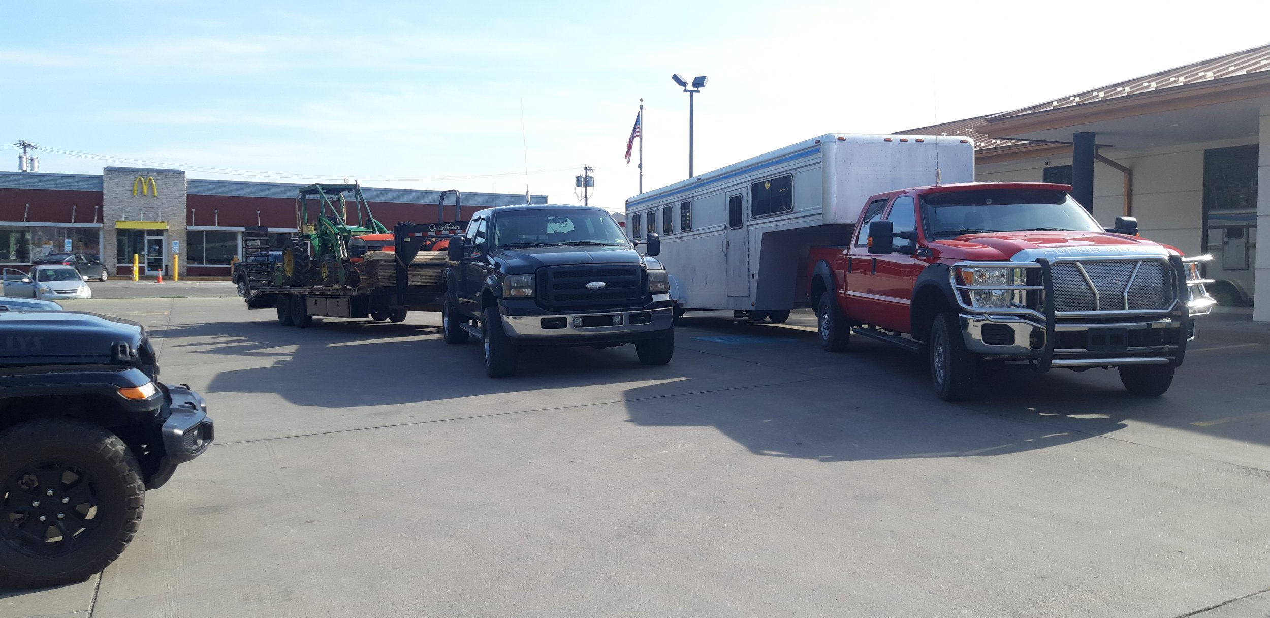

Here's our F250 gasser, pulls our 4 horse slant just fine, as long as you keep the fuel tank full... gets about 7mpg towing, but in all fairness, only about 10mpg empty.

Here's our F250 gasser, pulls our 4 horse slant just fine, as long as you keep the fuel tank full... gets about 7mpg towing, but in all fairness, only about 10mpg empty. View attachment 763172
Do you have the 6.2?
Yes, the red truck is a 6.2L gas motor. In all fairness, I also have (and prefer to drive) an '06 F350, 6.0 diesel with 6spd manual trans. We moved recently, 3 hours one way, and we ran both trucks, with trailers, every weekend, all spring and summer. The 6.2L keeps up with the 6.0 just fine, at double the engine rpms and 2/3 the fuel mileage. I'd like the 6.2L a lot more if it were backed with a manual transmission. But my wife likes it, and has no issues tugging a trailer with it.
