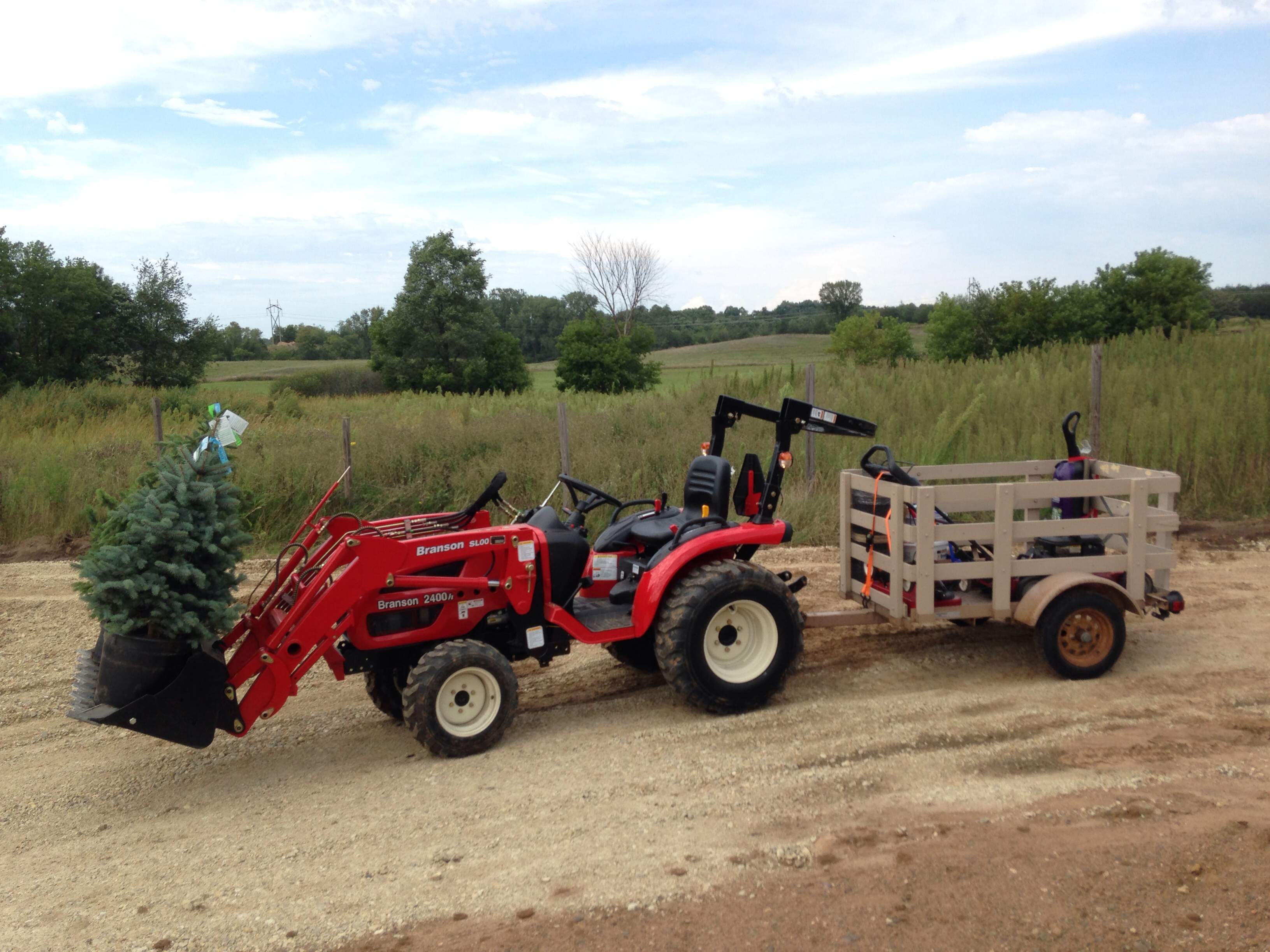

I towed my small trailer the other day with random stuff from a house move down to my shed. I just mounted a ball to the draw bar and it worked well for me. image.jpg
