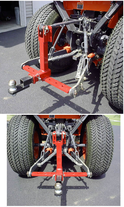

I made this hitch for my B2710 that takes a 2" reciever off of my truck. Works quite well when I have to move my 16' trailer around. I have seen these for sale in the Northern catalog.

I have a similar hitch hookup as Von. I bolted mine to the draw bar in case wanted to move it to a bigger tractor. See attached picture. I still have not painted it yet. /w3tcompact/icons/eyes.gif
My main use for it is to move my Bearcat chipper around. The tongue on this thing must weigh close to 100 lbs. /w3tcompact/icons/tongue.gif
I use the offset hitch to get the ball under the tongue when trailer is low.
