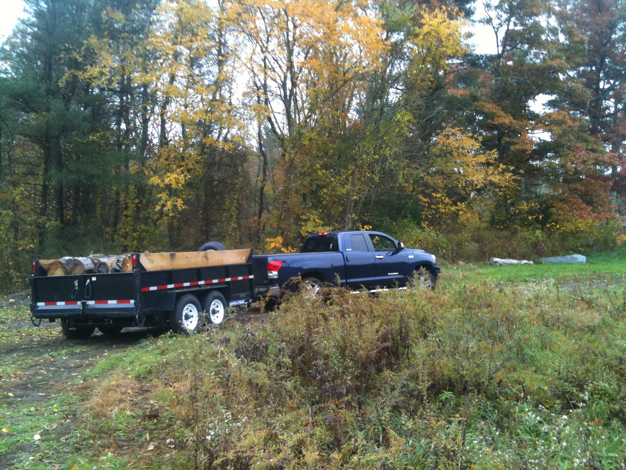

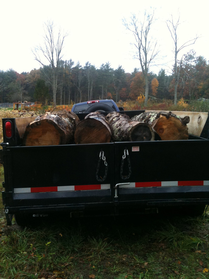

Here is a picture of when I used it, I hauled some logs he was getting rid of for use on my sawmill, it lifted them fine but they were all pine's and not heavy oak or something like that.

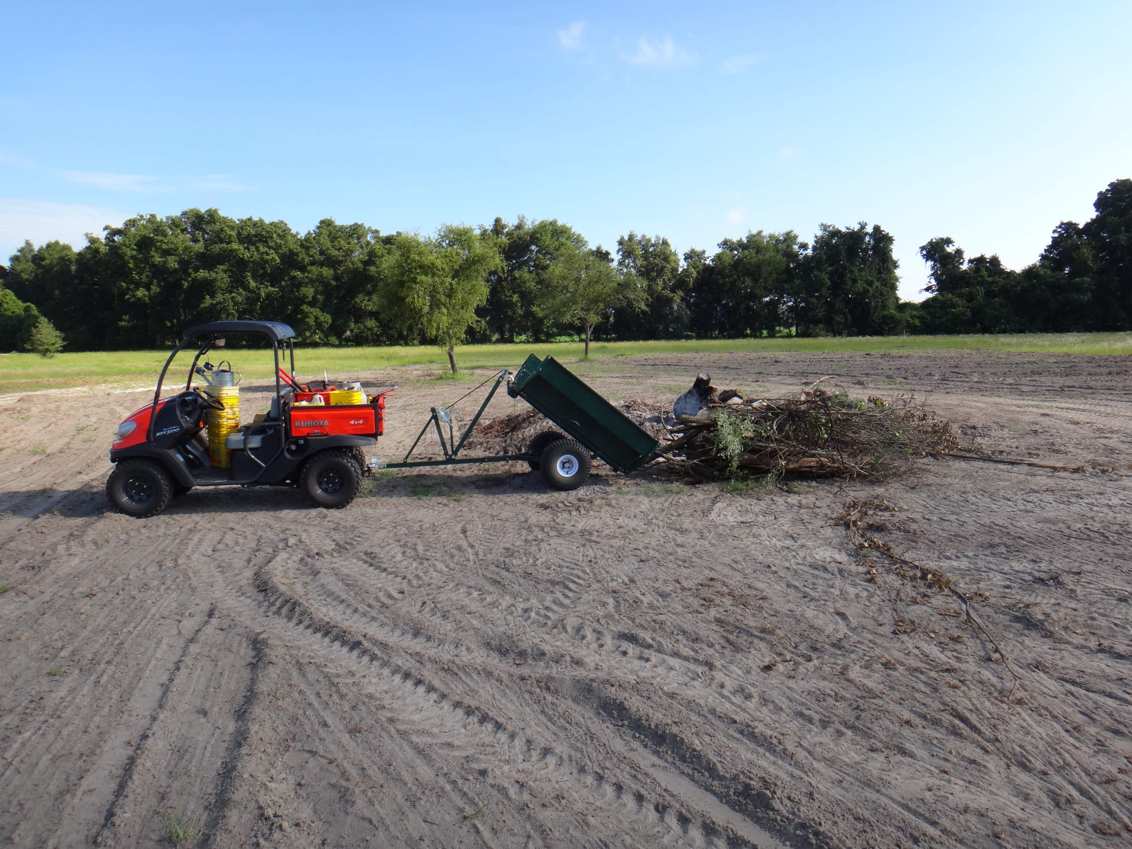

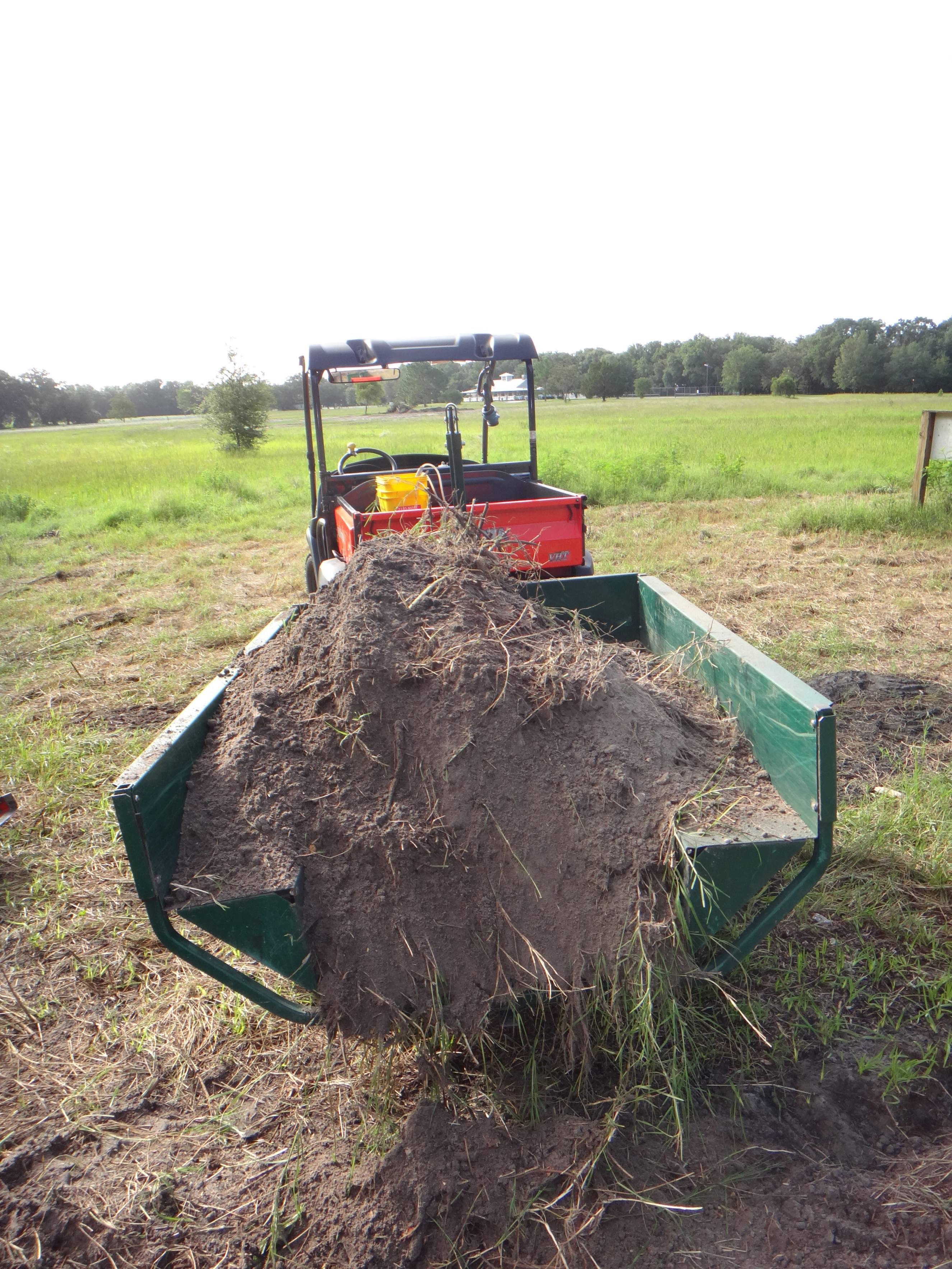

I pull an older, single axle MUTS trailer almost daily. Very stable as load is carried low, between the wheels. I am amazed that I can pull 1,000 pounds of dirt behind my 15.8-hp utility vehicle....but I need plenty of room to stop.
Now only two axle MUTS trailers are available.
Much lighter (1,500-2,000 payload) then what you are considering but it may serve you better than the heavier trailer.
Jeff, I've seen your trailer in other threads that you've posted in as well, I have always noticed it and really like the smaller trailer setup like that. Ideally I'd have one of each, something like yours for the trails, and a larger dump for hauling a couple cords of firewood or woodchips. I'm also planning on hauling logs once in a while which would of course require something more heavy duty, and larger. Nice pics and thanks for sharing :thumbsup:
