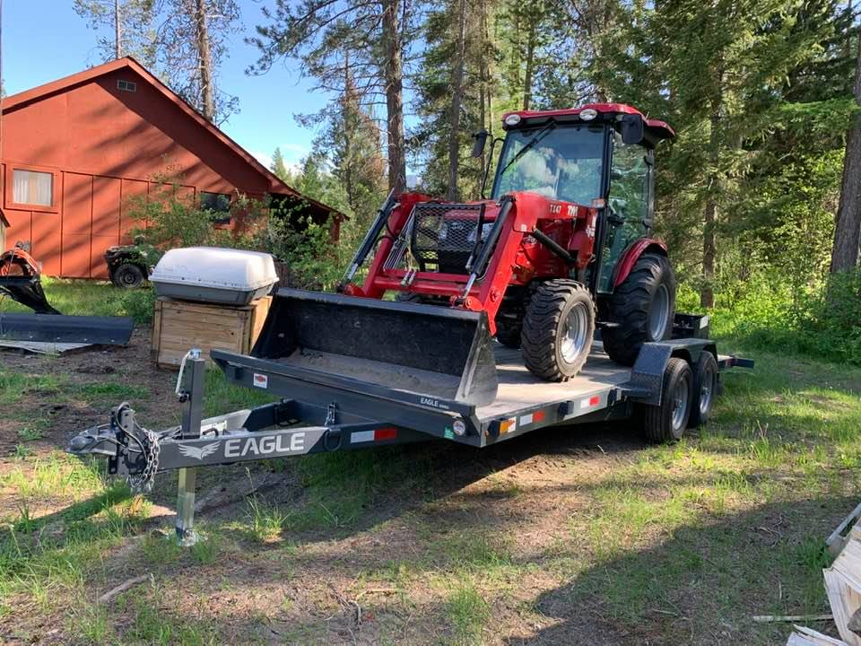

You'll be fine, just make sure you have more weight on the tongue than aft, it will ride just fine if your suspension drops 2-3 inches. Tie it down well, adjust the brakes as you go along in the beginning, keep your distance and keep it at or below 65 you'll be fine. Here is my rig that I tow with a 2004 Chevy Silverado 1500 W/T. My tractor is 4600# with loader, trailer is a 10k
trailer at 2400#

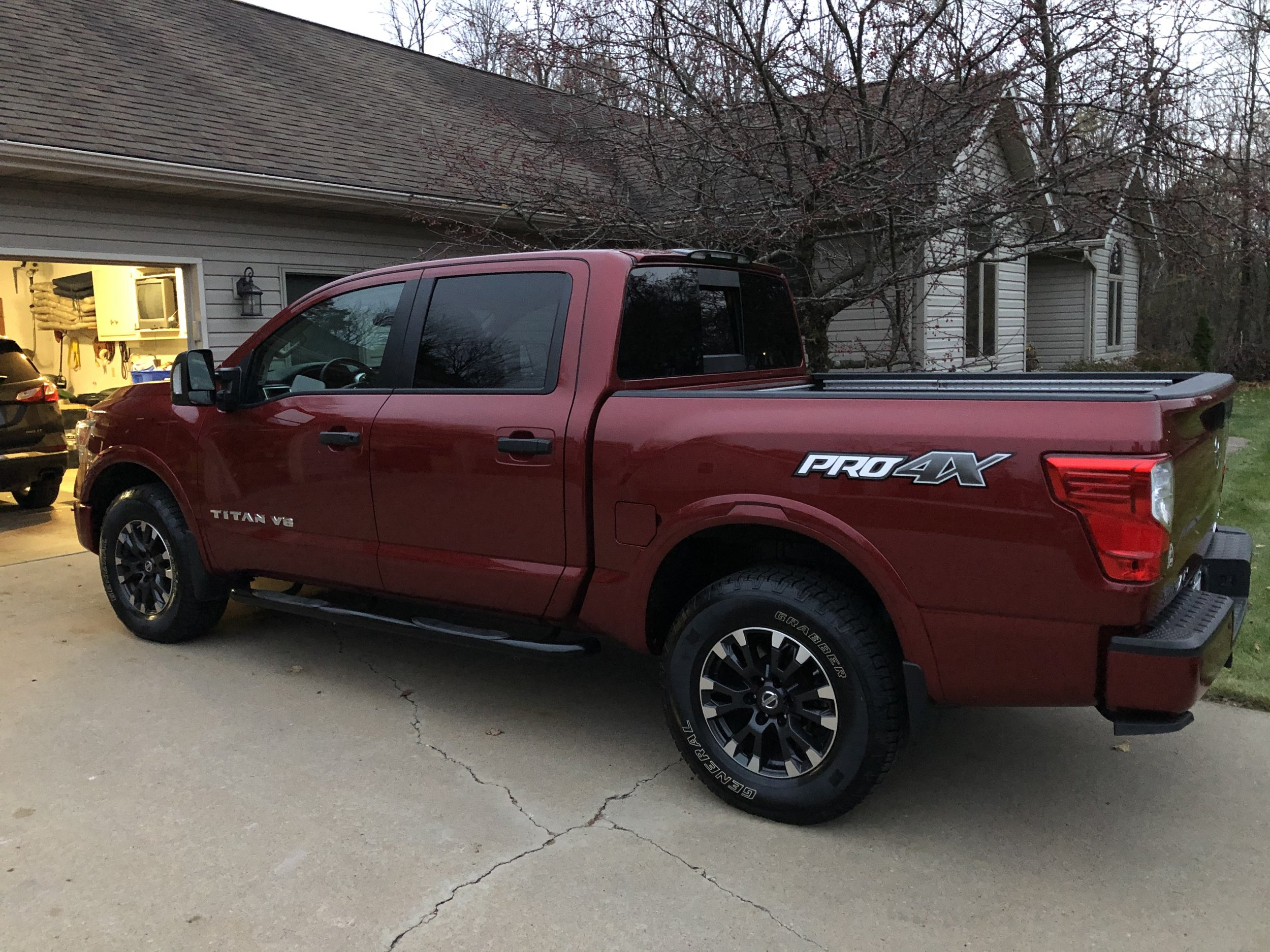

With 400 hp and 9400# tow rating ! Nissan’s Titan rule lol ! Yes yes I know Ford and Chevy with the bigger motors out tow it . Best truck for the money!
