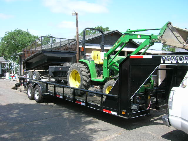

I have Chevy 1ton Dually that the previous owner lowered 3". As some of you know, I just bought a 24' GN trailer and when I loaded my JD 4210 tractor and and my dump trailer, the load dropped my truck down on the axle. Yesterday, I received my Firestone 5K lbs airbags, installed them and today I loaded tractor and dump trailer on the GN. Took it out for a 20 mile drive over rough back roads with 30psi air in the bags. Not once did it bottom out.
Sorry, no before or after pics. Just wanted to share how I overcame my delemma

When the previous owner lowered the truck 3", he may have removed some springs from the pack. If that's the case, he basically turned a one ton truck into a dual tire half ton.

I would be checking to see how they lowered it. Spring over converssion, removed springs, different spring packs, modified brackets, etc... As GIJOE said, if they removed springs then they have lowered the GVWR of the vehicle.

The previous owner had the rear shackles changed so it dropped 3". He did remove the over load springs. In the front he installed a 2" dropped spindles. All done professionally. I, on the other hand installed the 5K lbs air bags with an onboard compressor and gage myself.
I suspected that. Of course, I didn't so when I hooked up the fifth-wheel, it lowered the back of the truck barely enough to touch the overloads.
