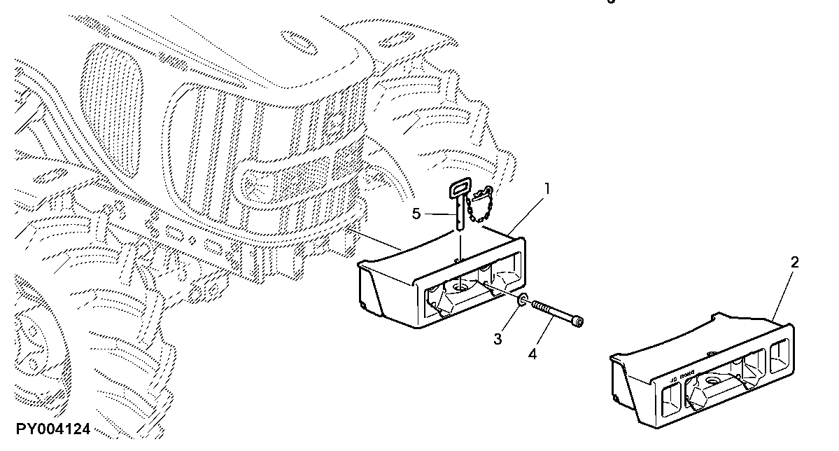

I would like to add a tow hook or clevis to the front of my JD 5105M. It has 4 threaded bolt holes in the front which I assume are for the weight bracket if you want to add weights. I was thinking of making a plate to utilize the four bolts and welding a piece of angle iron or two back to back to the plate with a hole to add a pin and clevis. If anybody has made one or has any suggestions please post.... I do have a loader but don't want to put that kind of stress on it if i have to be pulled at an angle.

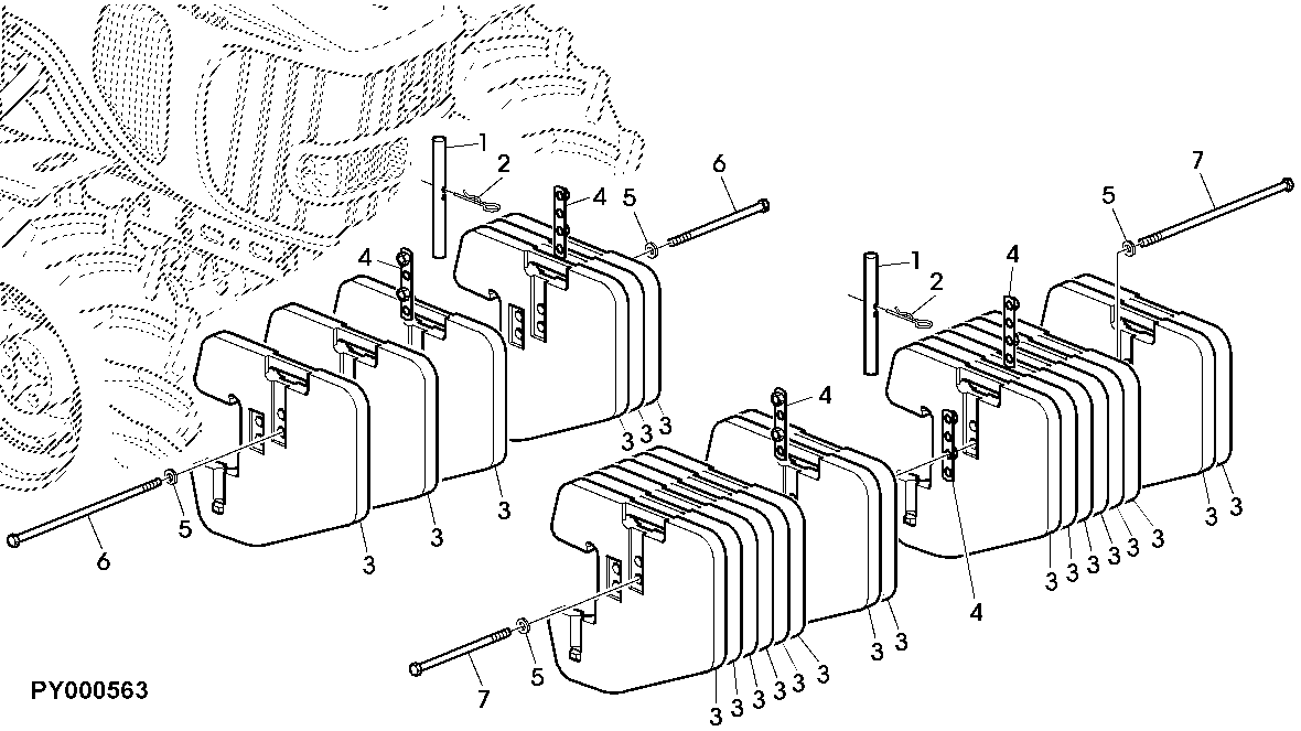

   / Tow Hook for front of JD Tractor? #4
You could get the front starter weight. It has a center hole for the pin used to retain the suitcase weights. It's big enough for a 1 1/8" diameter hitch pin.
I just checked into the JD weight bracket and it's over $400 bucks. Since I have the loader I will probably not be adding any weights. It was a good idea, but about $350 more than I want to spend. I will pursue the angle iron idea unless I get a better one. Thanks!
