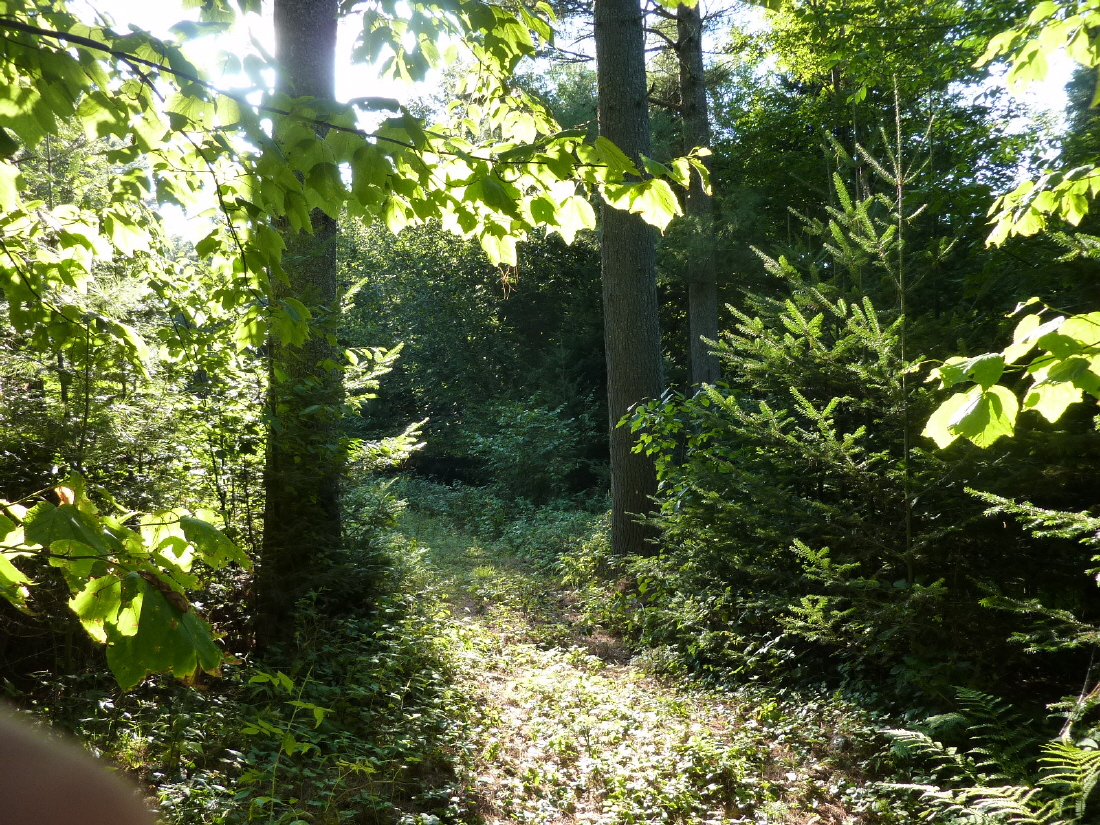

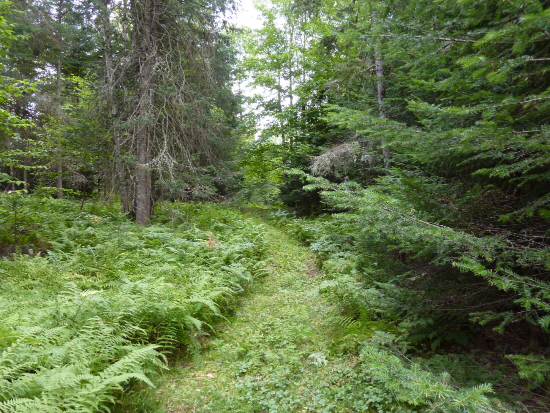

I've had a swisher rough cut mower for about 9 year to maintain trails at my cabin. It tracks quite well when offset and has been very reliable. Mowing with a belt drive atv is rather hard on the atv. The transmission on my Polaris gets so hot I have to wear an insulated sock to keep from burning my leg.
My only two complaints are the hitch is overly complicated. It's intent is to be able to adjust it to any situation, but it means needing tools to hook it up and disconnect from the atv. I took most of the complications off and put a 2" receiver on an attachment I made to get the right height.
The second complaint is how the blades mount. They didn't sleeve the bolt that holds the blade on, and instead make you very carefully adjust the bolt and nut together so there is enough play on the blade every time you change blades to sharpen them so they float free and they break away when you hit a rock.
Because it has only middle mounted wheels and level is based off the height of he atv hitch, you won't get manicured cuts unless he ground is level. Any hits or bumps that lift the atv will change the angle of the blades. Unlike a 3 pt mower, you can't adjust front dynamically when coming to a hill or ditch. If it's enough variation, it just drags on the front skids or pulls rough the ground.
