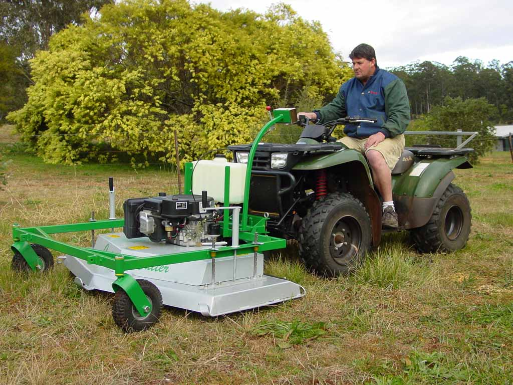

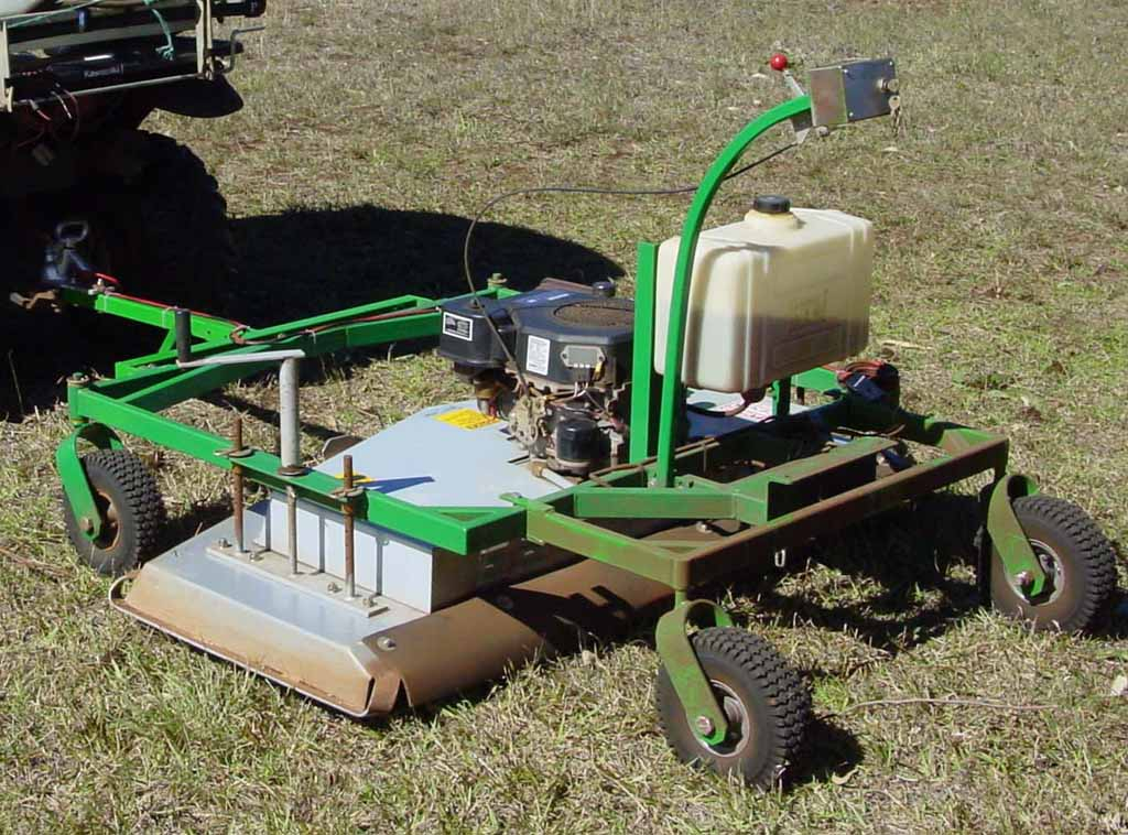

I bought a "push in front" mower years ago, but there were a few drawbacks, and the factory was able to sell me a conversion kit to make it a "tow behind" mower.
It has three cutting discs, for a total cutting width of five feet (60"). The original engine was a Kohler 16hp, but that proved to be a little underpowered, and I replaced it with a Kohler 22hp 2 cylinder - much better.
The dealer demo'ing the mower when he delivered it:
After conversion to a tow-behind:
We initially bought it to mow the grassed areas in our olive grove, which covers about 5 acres. I wanted to avoid soil compaction as much as possible, otherwise I would have simply used the tractor and 6 foot slasher (rotary cutter).
The drawback with the original push mode was that the operator on the quad bike got the fumes and clippings/dust, and it was almost impossible to change direction on even a slight slope. This was because with the mower fixed to the front of the bike, the whole structure became, in effect, a six wheeler with the steering wheels in the middle of the string! The factory must have anticipated that some owners would want the tow-behind version, as they already had the two lugs on the front to accept the drawbar.
I mostly use it in offset mode, to better mow under the olive tree canopies. The finished mowed area is very smooth.
