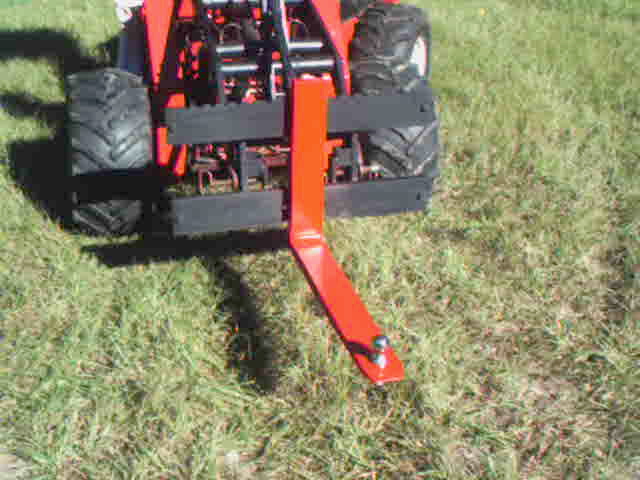

HI,
THIS IS A TOW ADAPTERS THAT I MADE TO TOW TRAILERS, BOATS, ETC. REAL EASY TO MAKE. I USED THE FORKS AND BACKING PLATE FROM A SMALL FORK LIFT. COST ABOUT $ 150. WELDED THE THREE POINT HOOKUP ON THE BACK . ON THE FORKS, I CUT A 1 INCH HOLE IN THE END OF THE FORKS, AND PUT A BALL ON THE END. THESE FORKS ARE 3000 LBS UNITS. ON THE BACKSIDE, WELDED A RECEIVER TO THE FRAME. I CAN TOW LIGHT WEIGHT TRAILERS AND SUCH, ALSO GIVES ME A LIFT POINT .
J.J.
