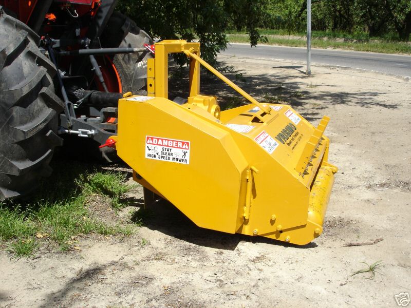

My shredder has hammers. I think the S300 comes outfitted with knives but hammers are options. I think the S500 series come standard with 2lb hammers. The width of these machines can be huge. You have plenty of space with 12 feet to work with but with only 37 hp, you are going to be limited to a more reasonable size that your machine can handle.

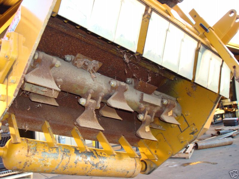

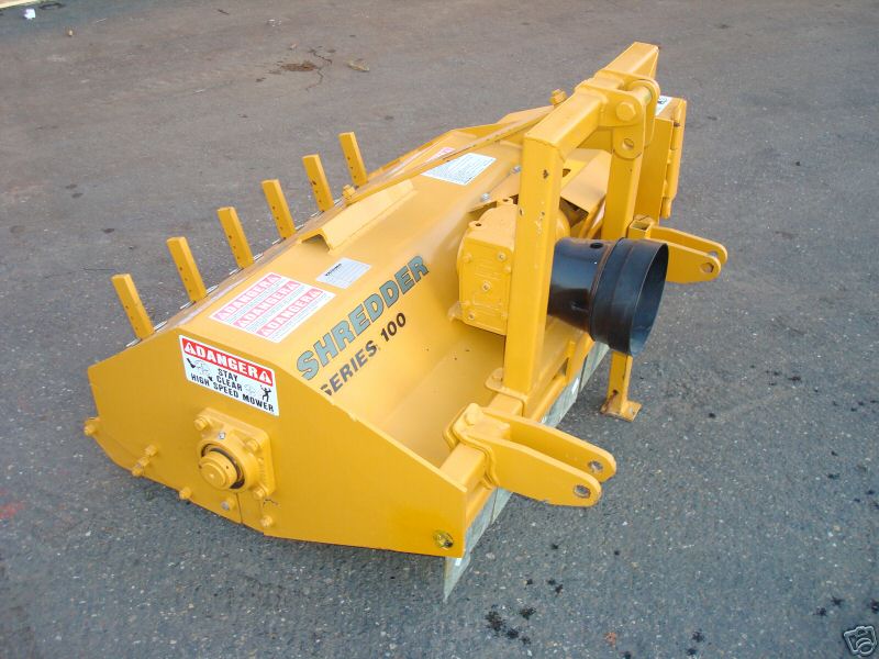

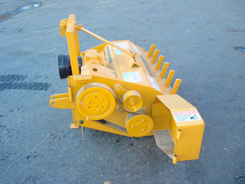

Fred, My 3' shredder is no longer a current model. The closest thing they have to mine is the 4' S300-4, come standard with flail knives but optional with hammers. The machine is built plenty heavy duty and can take the hammers with no probs. The S500 are heavier still and comes with even bigger 2lb knives. Hammer kit again is optional. I was told that my model was discontinued because it was too expensive to produce compared to the current S300 series. The list price was $7450, which is A LOT for a 36" mower.
The Gearmore GML49 weighs 580 pounds. The GFC41, which you are having better luck with, weighs in at 615 pounds. By comparison, the closest that vrisimo has in size for their current S300 series is the S300-4, weighs in at 1170 pounds. My S100-3 weighs a little over 800 pounds. I keep going back to the weight because it generally is an indication of how heavy the units are built. Again, these are "orchard" grade or severe duty units. I initially wanted to buy the GML49 which I thought was top-of-line quality but when I saw the vrisimos, they just blew me away. The build quality was far superior and lucky for me, I got a great deal on mine as they were closing out that model. I highly recommend these machines.
I've enclosed some more pics of my mower. The current S300 series and S500 series are similar, almost identical, in my opinion.

You said that your mower weighs 500 pounds. I've got to think that it is more. By comparison, at the 75" width of the TM-1900, The gearmore weighs in at 740 pounds and the Vrisimo S300 weighs in at 1470 lbs. The S500 even more.The hammers of the gearmore are slung on link ends. That might be the weak link, I don't know. The Vrisimo hammers are mounted directly on hardened bolts without links.
