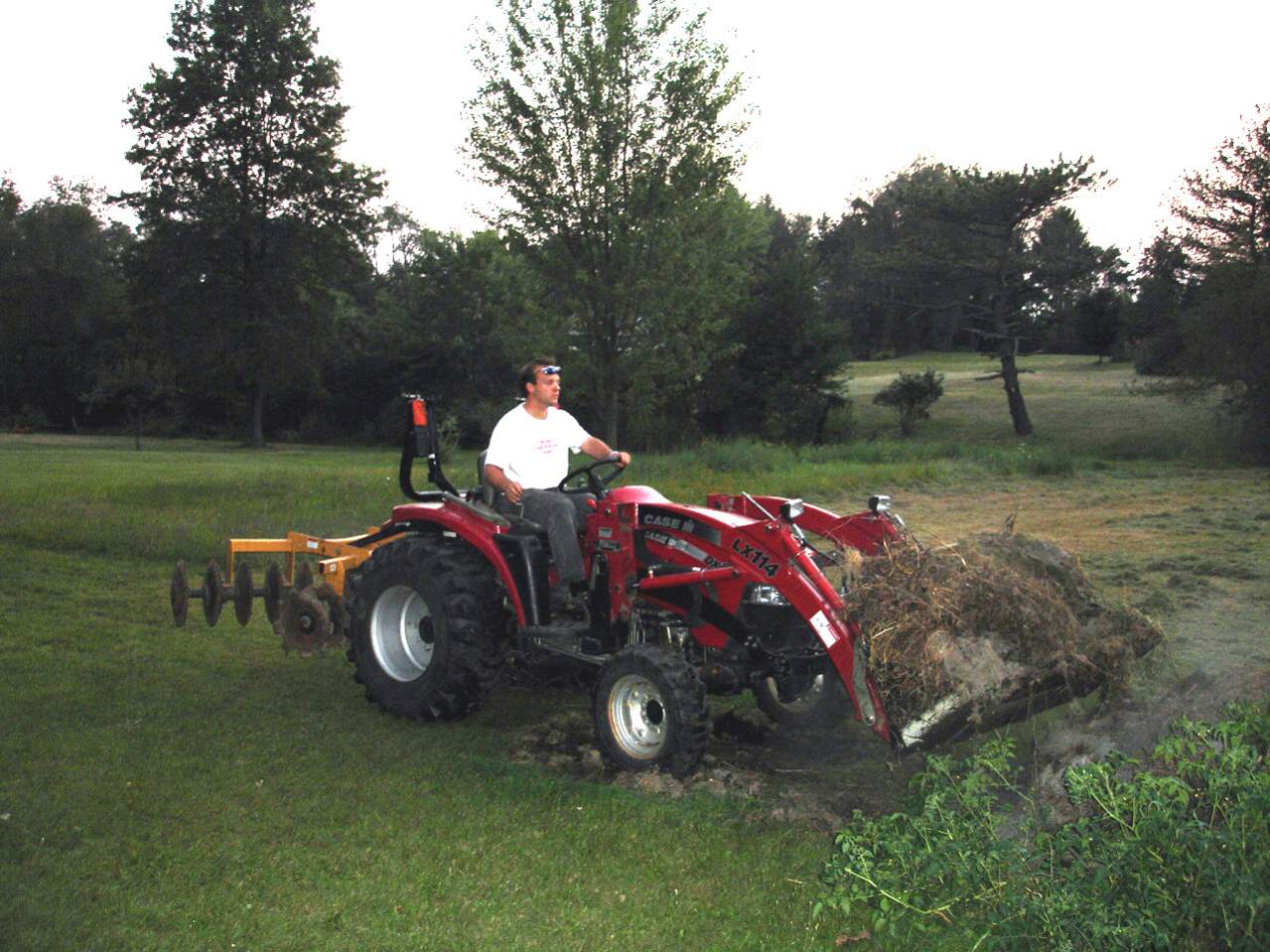

I've got a 2005 DX33 Case/IH that I absolutely love. It's got 690 hours on it and has been well maintained from what I can see. (Bought it with 66x hours on it).
Recently, it's become a bit hard to start. I'm wondering if the glow plugs are starting to fail or if it is the timer. I just installed a block heater to help out but haven't given it much of a shot.
I turn the key on and the glow plug light stays on anywhere from 4-6 seconds. I can cycle the glow plugs a few times, but it still seems a bit slow to start. (cranking for 15 seconds or so). It's not cold here yet, but I'm sure it'll only gets worse as mother nature gets grumpier.
Battery has tested well, but the tractor seems to crank a bit slower than what I think it should. The starter solenoid will occasionally only "click" until the 4th or 5th turn of the key, so I have a new starter on the way.
Glow plugs? Starter turning too slow?
