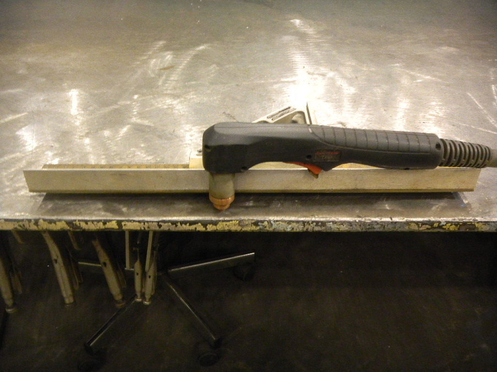

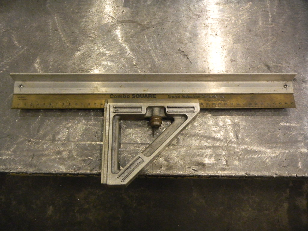

Lanse do you use any kind of air drier?
Remember when you plasma cut aluminum, and you're going to weld on the cut edge of that piece, you need to cut 1/16" or at least 1/32" big and sand / grind to the desired dimension.
You need to get one of these. ;)

Is the purpose for cutting big with aluminum so that you sand out impurities deposited in the aluminum while Plasma cutting?
   / Torture Testing a Chinese Plasma Cutter (Videos) #8
Yes, but I only have personal experience with Tig welding. It may not be an issue when Mig welding aluminum after a plasma cut. :confused3:
