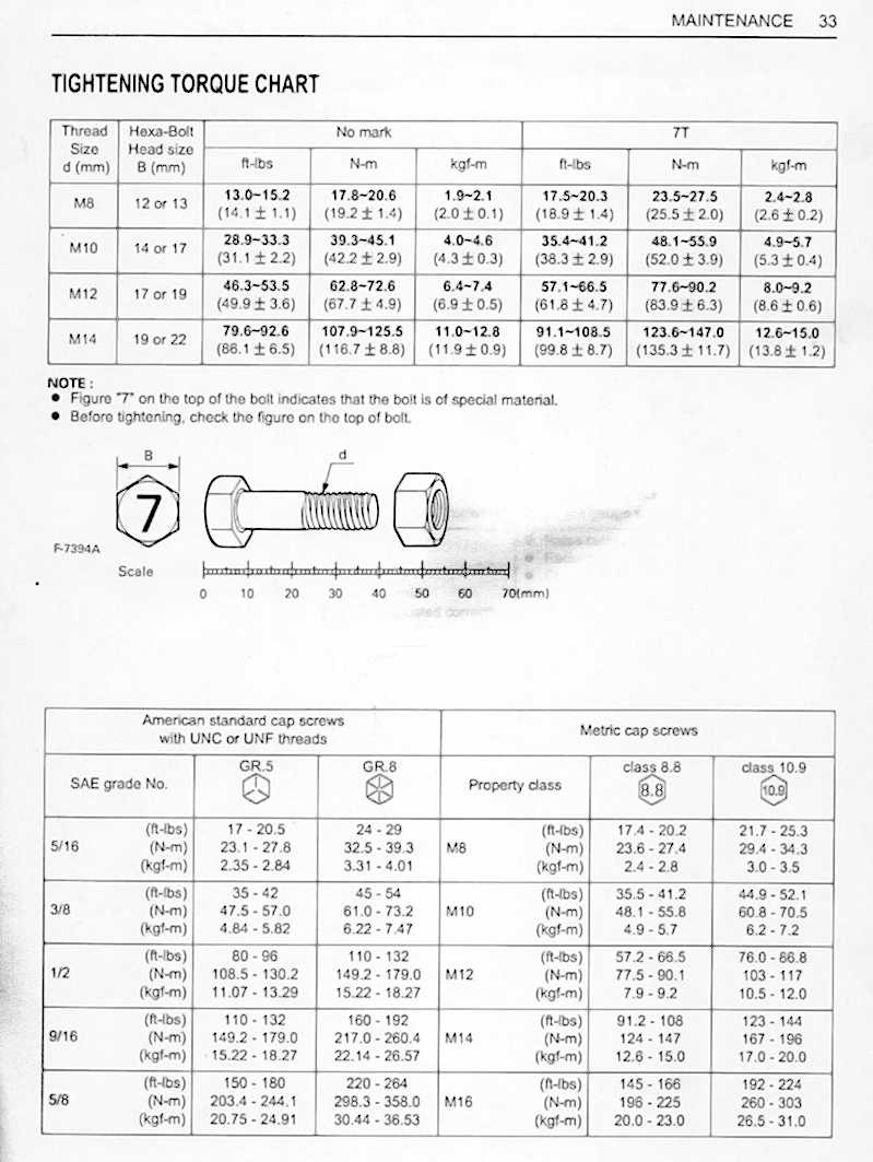

Apr 21, 2006 / torq. specs? #1 B bedway Member Joined Apr 10, 2006 Messages 33 i have the rear end of a B7200 apart. Does anyone have any specs. for torqueing the bolts, or where i can find it? thanks in advance.
Apr 22, 2006 / torq. specs? #2 wushaw Elite Member Joined Mar 6, 2005 Messages 3,190 Location Bristol Texas Tractor Kubota L2800, 15 hp 372 Mitsubishi If you happen to have an owners manual handy there is a bolt size/ torque chart in it for all the bolts.
Apr 22, 2006 / torq. specs? #3 Stef Platinum Member Joined Mar 13, 2005 Messages 735 Location South Quebec, Canada Tractor Kubota B3030 TLB, TYM 330 Hi Bedway try this torque chart /forums/images/graemlins/wink.gif Attachments 870470-Torque chart.jpg 87.3 KB · Views: 199
