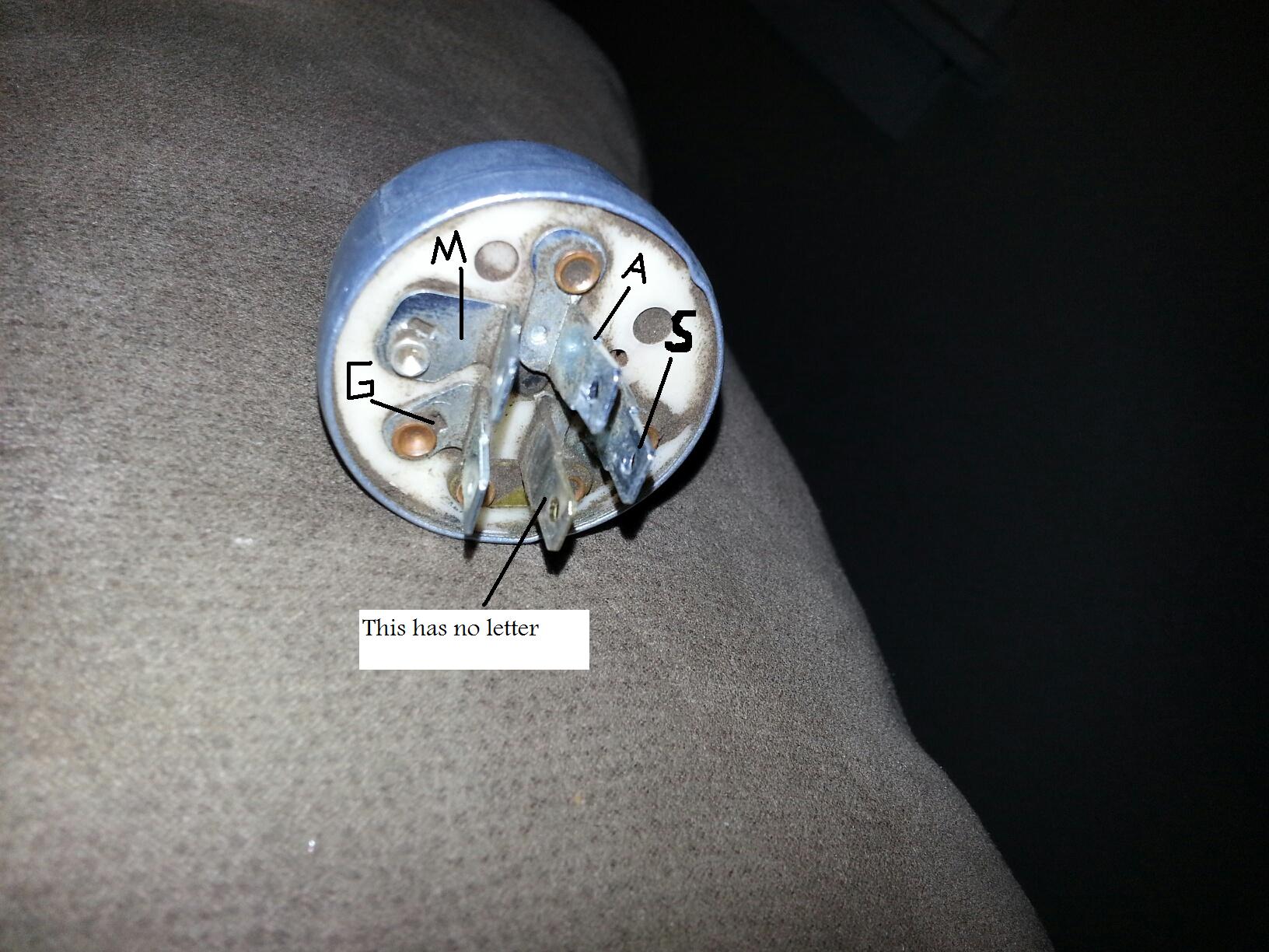

A few years ago the dealer put an ignition in, the plug in was bad, so they had to cut and put spade connectors on all the ignition wires, I unplugged them without marking what went where. Now im at a loss as to where they go on the ignition. The manual, doesnt match up to the colors, or ignition letters.
I have an orange, blue, red, yellow, white.
The ignition letters are as follows.
Does anyone know what colors go to what on this?
Its a toro 265h model 72046
Thanks in advance, Jeff
   / Toro 265h Wont crank over. #10
All I can tell you is S-is Start, G- is ground, M- is magneto (coil), The blank one I think will be Battery, A- should be to accessories. Use and ohm meter and test each of the terminals, with key off G should be connected to M,
with key in start position, S will be connected to Battery? (Blank one), key in run position, Battery will be connected to A?, and so on.
Then you need to test the wires on the tractor to see where they go to, one is from Battery, one will be the cranking (start) wire, one will go to the coil / shut down circut, and so on
