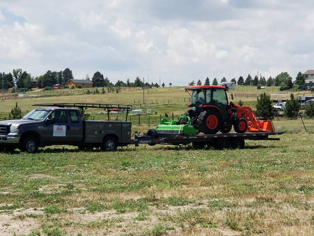

Trailer weight + load - tongue weight (8-15% of total) needs to be below the combined axle rating. By 20% or more if you dont want to beat up your equipment by pushing it to the limit.
My 14k 22' deckover power tilting deck weighs 4k lbs all by itself. Leaves me 10k lbs for a load. Tractor is 5k, heaviest impliment is pushing 2k. My trailer is a bit heavy, but a 10k trailer is probably north of 3k. Very little room if you haul an impliment or 2 with that tractor before you eat into a reasonable safety margin if not legal limits.
Tow rating on my 2005 F250 is 12,000lbs so that & the GCVW are the upper limit of my legal towing limits rather than than trailer capacity. My 11k of junk behind the hitch pulls well, but I'm not to excited to push it much further.

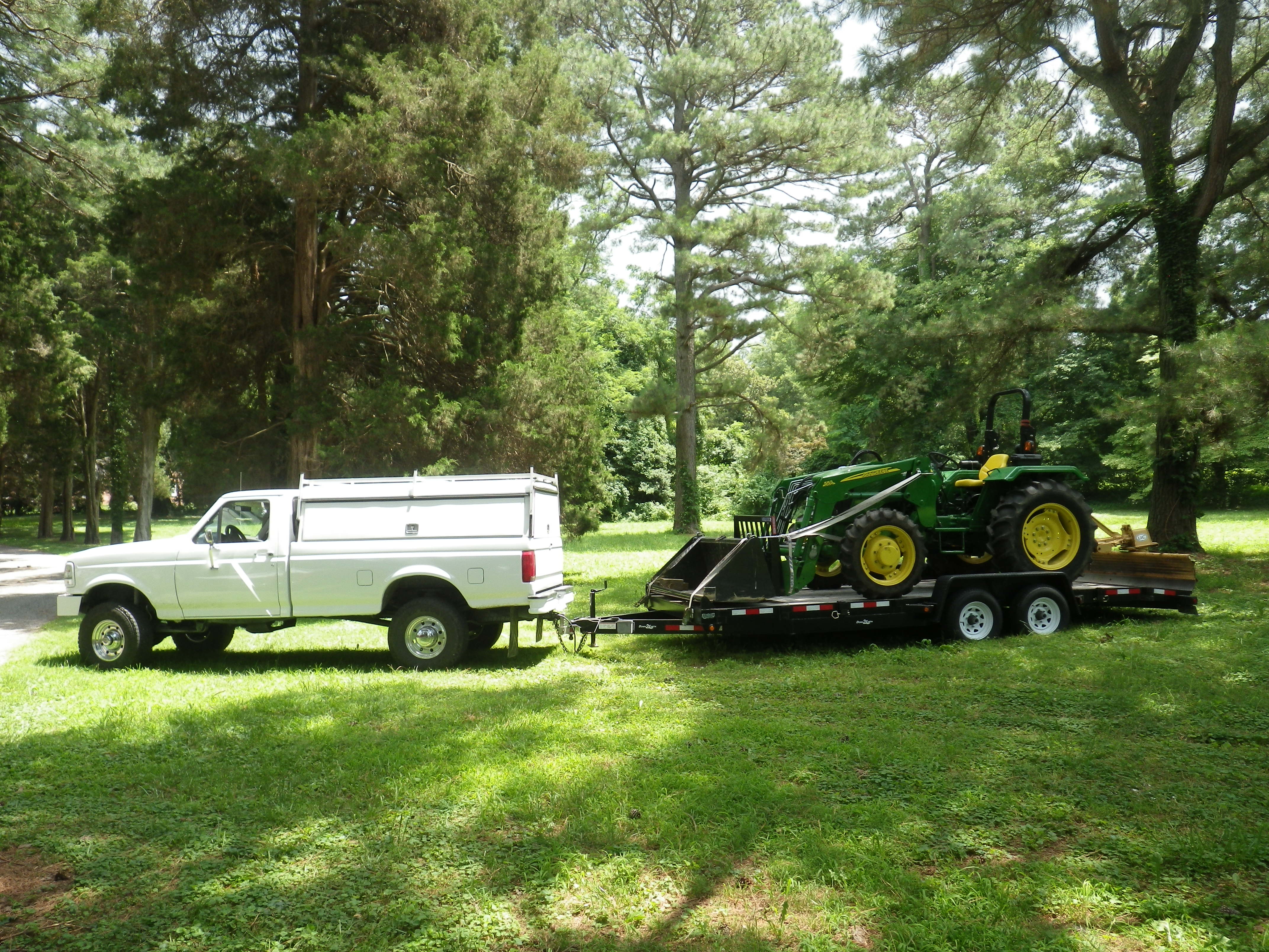

I have a 20' 10K car trailer. I did upgrade the tires on the trailer to 16" rims with LT tires rated at 3000+ lbs per tire. It weighs close to 2700lbs with the heavier tires. I haul my JD5055E on it. with the FEL and an implement on the rear it's close to 8000lbs. I have no issues with it. I would like to sell this trailer and get a 22' 14K trailer, but it was cheap and does 90+% of what I need. I can use my GN when I need more.
I am not a fan of tilts, but that's up to you. I do like fold flat ramps that can be locked upright like the PJ monster ramps and the BigTex mega ramps.
