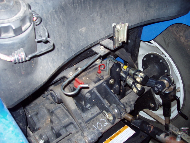

When I got my 1210 there was a 'bracket', for lack of a better term, which held the toplink in an upright position when not connected to an implement. Since I leave the toplinks with the attachments most of the time, I determined the bracket to be superfluous, and I got rid of it. Well 20 years later I have come to wish that I still had that bracket on occasion. I have googled toplink bracket, toplink holder, and a couple other variations, and all the links that come up are related to the bracket with 3/4" holes that holds the business end of the toplink. The unit I need is a J-shaped clip made of
1/4" wire that snaps around the toplink when not in use. Does anyone out there have a picture of this gizmo which I can use to re-create one for myself? Thanks in advance

It is quite easy to use a 3/8" or 1/4" all thread to bend it any shape to hold the top link. All thread is a piece of continuous threaded metal rod to do variety of construction tasks such as hanging stuff off of the ceiling and such. I salvaged a 1/4" piece of steel rod that was chrome plated out of some metal furniture.Nothing fancy but does the job. A piece of rebar being ductile is easy to bend to just about any shape, can be wire brushed clean and spray painted to match.

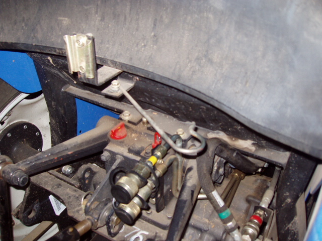

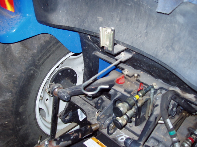

This is factory equipment on my 2002 NH TC-40S. The top link bracket is in combination with the slow moving vehicle bracket above.

Thanks, Nickel. Pretty simple, but it's nice to see how they do it at the factory
