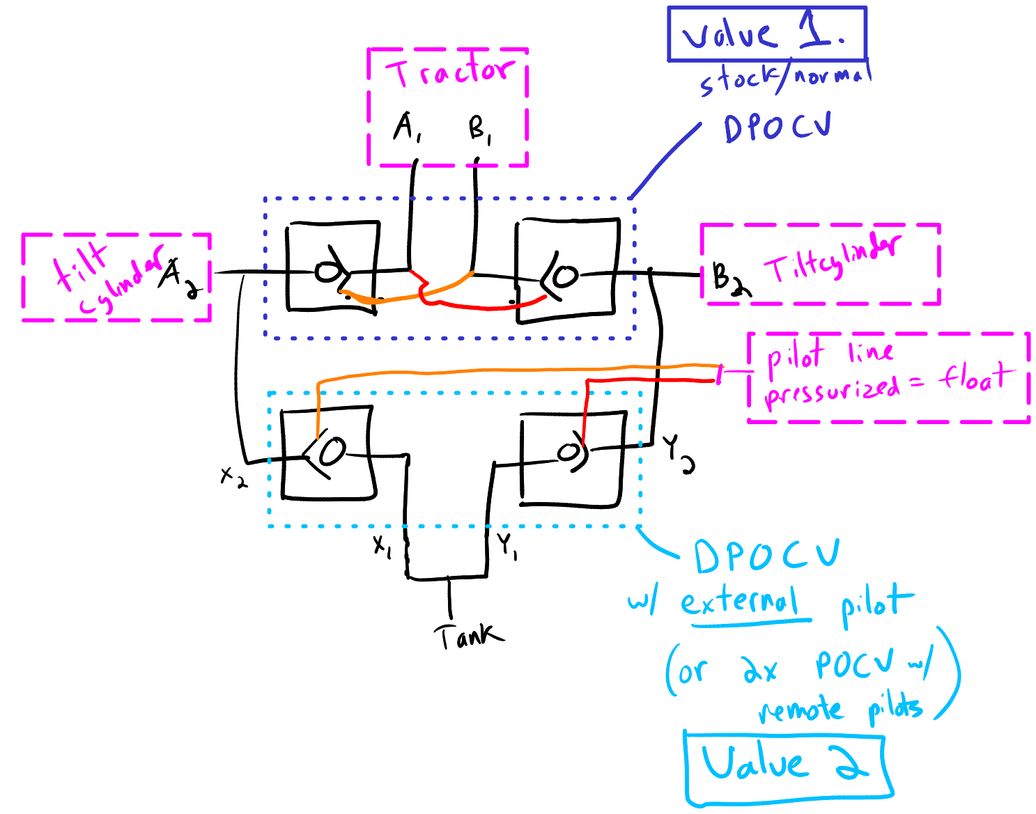

Typical top&tilt cylinders use a normal Double Pilot-operated check to prevent drift. Dark blue Valve1 in the picture. All these uber-compact double check valves use internal pilots for the obvious reason of size & cost. However, if one exposed the pilots (eg "remote" or "external"), then using two DPOCV I believe you could trivially get ALL the benefits of no drift, while still getting full float capability via a simple additional hose (smallest size available - it's just a ~zero flow pressure/pilot line)
What's the most compact Valve2 (light blue) I can get?
thanks!

In concept that would work but you must also prevent both pilots being pressurized by same signal during normal operation
   / top&tilt - float while retaining DPOCV
I think you're getting a how to DEpressurize valve2's pilots, right?
I had assumed that leakage of either the solenoid valve i'd use to control the pilot line (basically 2 position, dead-headed into the pilot line) - or leakage/minkr flow through the pilot itself - would take care if bleeding off the pressure once you turn float "off". A manual type valve coule also be used to drive the pilot line .... i suppose those are tight enough that the line would ONLY depressurize as the pilot "leaked", which could be too slow to be practical?

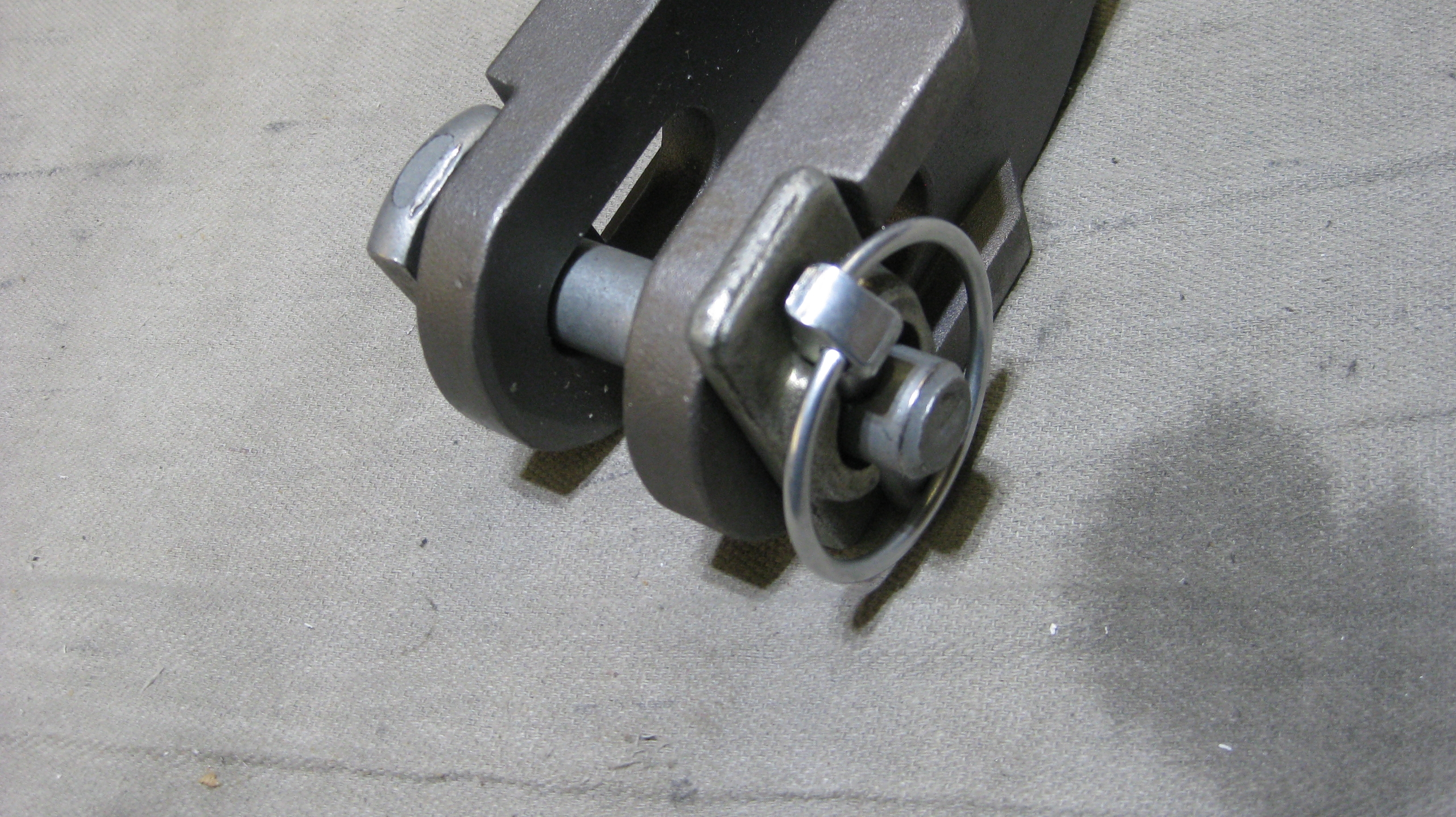

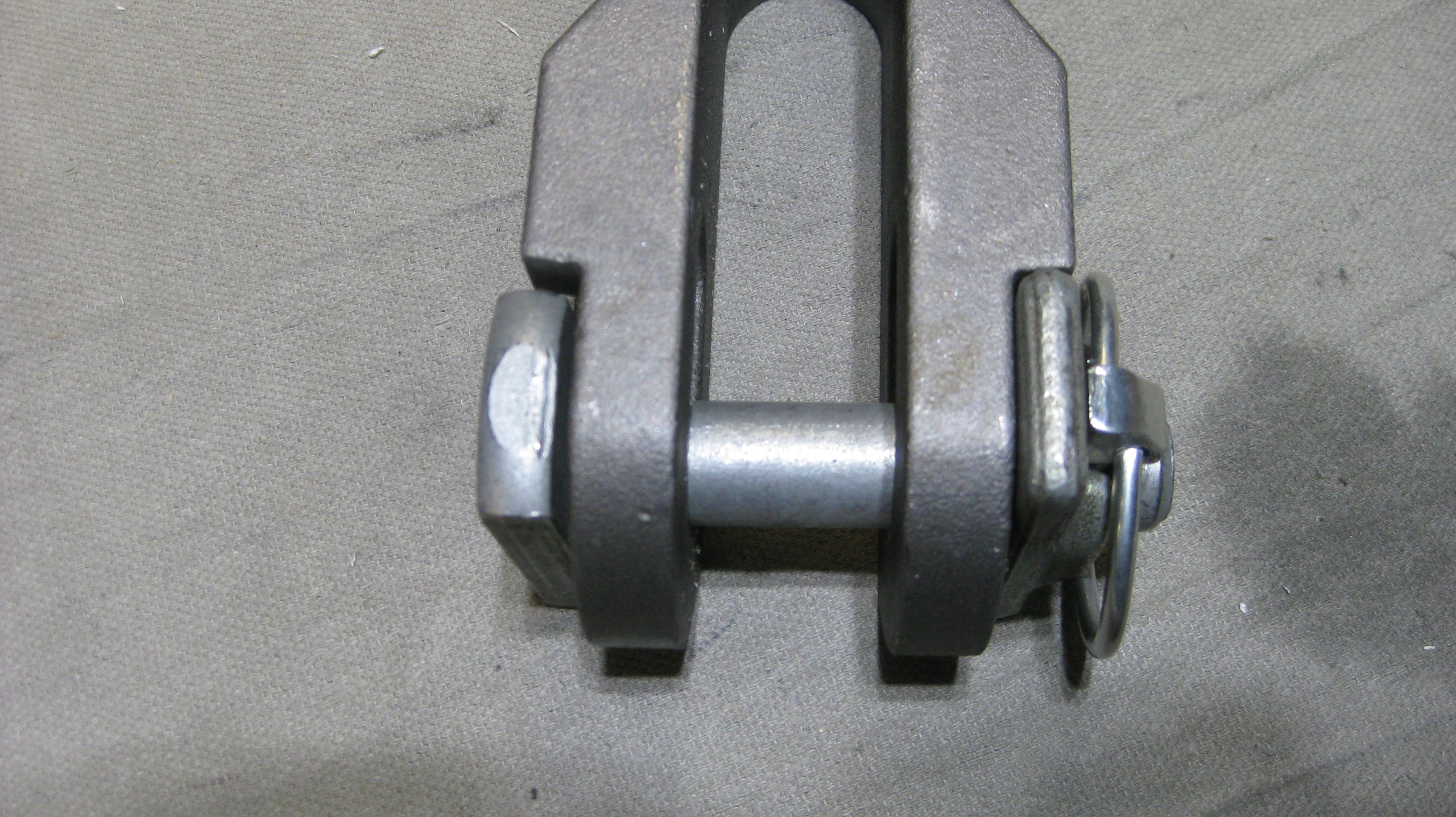

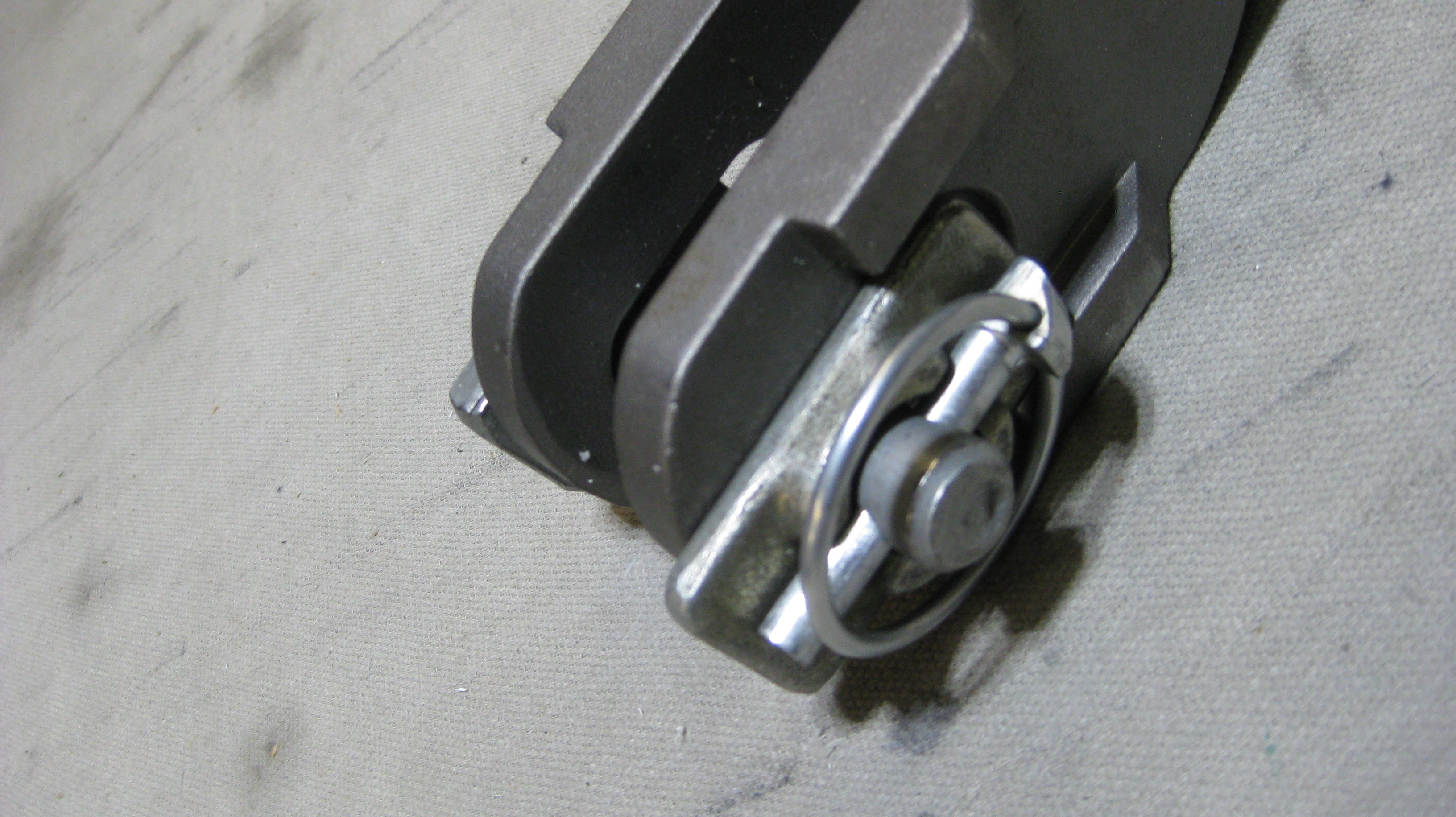

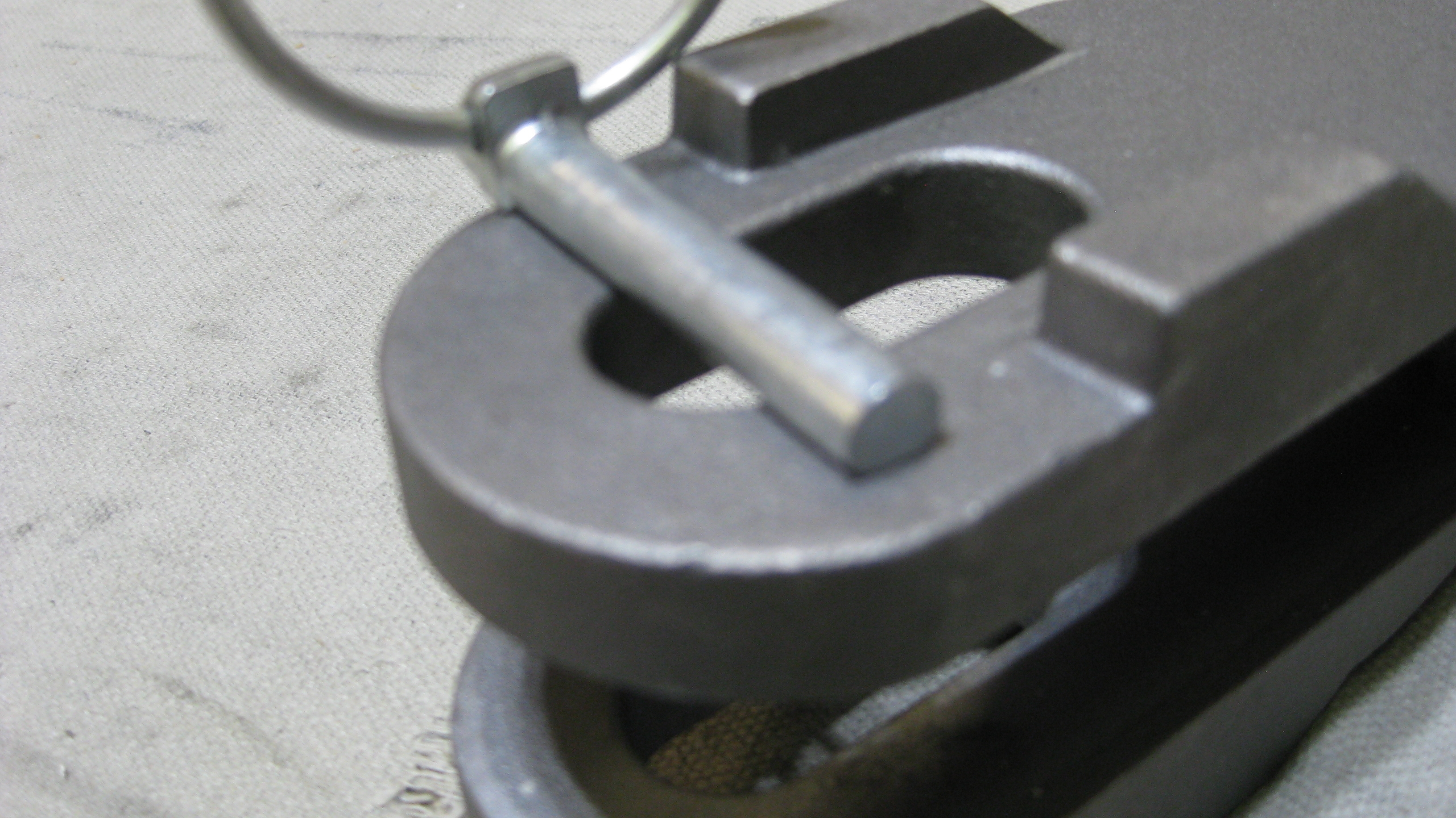

If you need both a check valve and the float feature, then put in an end similar to what is pictured and remove the hydraulic issue.
Thanks. I hadn't seen links with the slots, those are clever. I have a couple implements "sized up" vs my tractor, such as a large blade, wbich have that built in. None of the economy or true "cat1" size stuff i have ever considered have it which is a shame.
Not compatible with wanting a quick-hook top afaict, but a good, simple solution nonetheless.

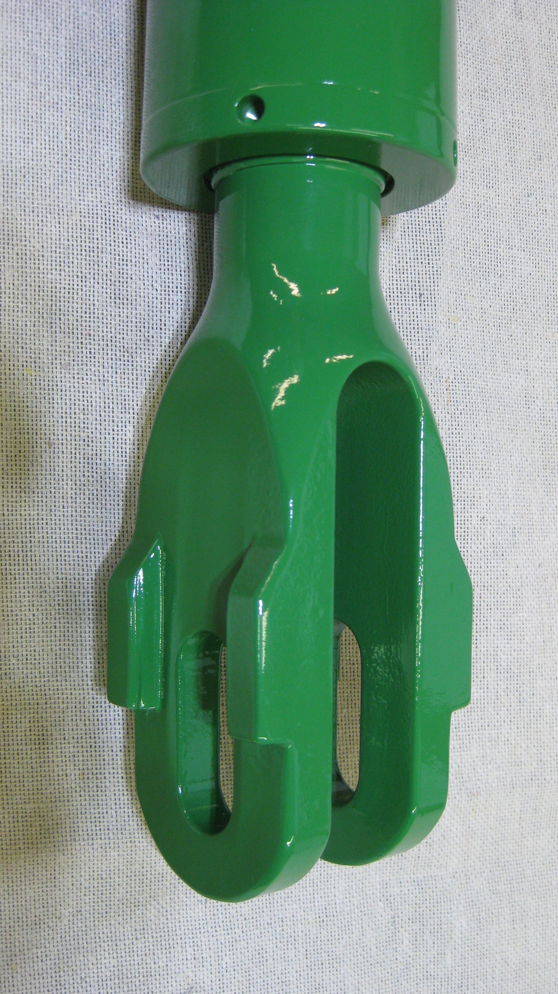

I did not mean on the top link. (If) the implement has possible gains from having the top cylinder in float mode, then either have the float feature with the control valve of put a slot in the implement top link mount or get one of the Y pivots that are for the top link mount.
Why do you think that there is any play in the ball swivel with any of the Euro hooks?
Mine are all tight. A ball swivel might be tight when new, it doesn't take that long for them to start loosening up, not that it is any more than 1/16".
The picture below shows where the slot float feature is on a side link. This feature takes a rectangular head pin that either has the pin locked down at the bottom location or is turned vertical to allow the draft arm to float up-down.
Makes more sense you were talking side link. That's a clean & elegant solution to get a small amount of side-to-side float. Is it enough? I don't know. You're skilled & popular enough you're booked out pretty far - so due to insufficient planning I'm going to spend a bit more, and invest a bunch of time, trying to get the full range :) At least it will give me something worthwhile to use the machineshop for!
