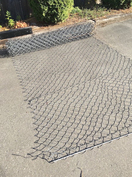

One man's trash is another's treasure. I scavenged a roll of chain link fencing from the recycle station and thinking I could use a piece of it to make a screen. I have a bunch of nice decomposing soil with lots of sticks and a few rocks in it left over from the clearing debris. I have burned most everything but the remainder is pretty rich soil. I am thinking of welding up a frame and attach the fence material to it. Want it to be portable maybe with folding legs tall enough to allow for a decent sized pile underneath and a way to dump the stuff that doesn't sift through.
Anyone have some ideas or designs they have made for such a contraption?

If you decide to use this, make a frame like a gate, but stronger. Put in lots of cross supports, as chain link fabric will stretch and sag a lot if you are dumping in bucket loads at a time.

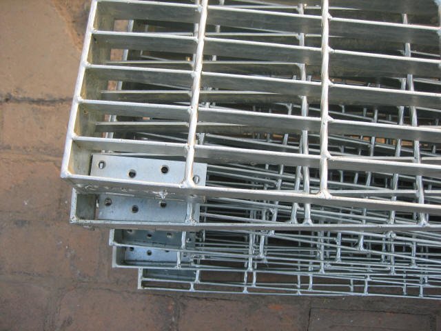

I've thought about using bar-and-rod style safety walkway material if I ever find any cheap.

Thanks Handloader... I've got some thinking to do after watching a few youtube vids. I wasn't thinking of making it so 'fancy' but I can see a vibratory motor set up would be very sweet.
Bruce, I think my chainlink fence idea is not going to work too good because even with a slope I think too much debris is going to get hung up. I might just have to make a drag with a piece of it instead. I like your walkway material suggestion. I don't come across that and gather it won't be a bargain but who knows. I also like the idea of having two stages and both being appropriately sloped to shed material.
