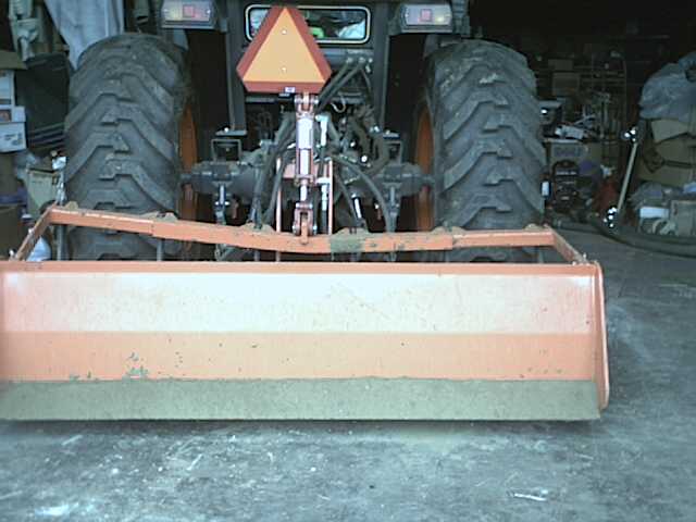

Just got my box blade back from waranty repair. They replaced the square tubing that raises and lowers the scarifiers. That tube and the two arms that support it and let it swing both bent. The tube was bent slightly up in the center and the two arms bent near their pivot points. They bent enough to chip the paint off.
The attached picture is after about 4 hours use yesterday, some of which was in a light rain. No rocks, just dirt. I pull this behind a Kubota L4610HSTC. Note that the left support/swing arm is bent again and the square tube is bent again, just more so than last time and in the opposite direction. Seems like a real quality box blade except for the hydraulic raise/lower part.
My salesman (Kubota dealer) saya you should be able to raise and lower the scarifiers while box blading without damaging the equipment. What do Y O U think?

My Land Pride is much heavier than the unit in your picture. I would ask your dealer for a Box Blade rated for your tractor size.

It is rated thirty to seventy horse 2 or 4wd. I may trade up to one of their "Industrial" rated models, hundreds of pounds heavier in the same size but I will probably go up in width 6 inches. Currenty 6 ft but next size up will more nearly cover my tire prints and since I suspect this will be a one time good deal on the price I better go for it. If they offer a good price consideration as a means of handling this customer service issue, I'll buy as much box blade as I think I can pull. Difference in retail cost is well over a grand to move up two levels of heavy dutyness. We'll see what they offer and what I decide to get. I'll post the results after Monday's revelation.

You should be able to beat the heck out of a box. So there is a substandard design in the hydraulic bar. So I would try to trade out while the gettin is good. Before the warranty expires. Helps to have a dealer that stands behind you.
