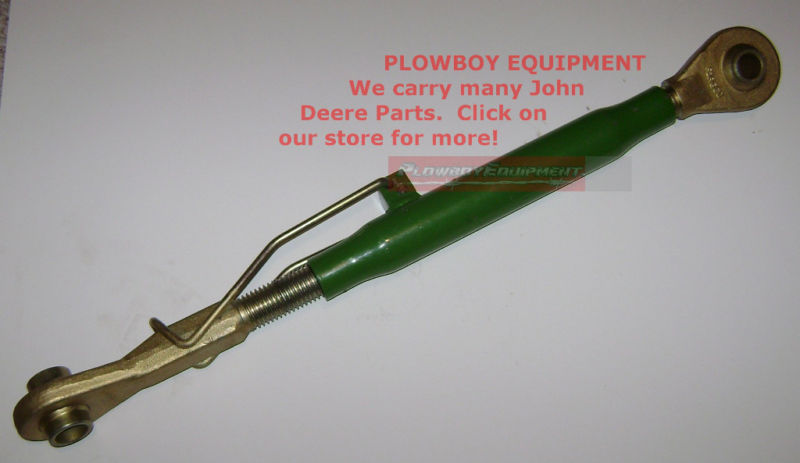

Hi All
Have what might be a stupid question though maybe not, saw a top link for sale on ebay have attached a picture of it. I have just recently bought a John Deere 2130 though it did not have a top link for the 3ph. Prices at JD are 'wow' lots so saw this on ebay, vendor is plowboyequipment. Anyone bought there?
Has a Cat 1 on one side and Cat 2 on the other, perfect for my snowblower since it is Cat 1 and the only implement that I have.
So in the list of supported tractors around my model number is 2040,2140,2150. I think that the 2130 was exclusive for Canada which is where I am so it might just not be on the list or maybe it won't actually fit mine and that is my question, do you think that it would fit?
Adjustment is 21 5/8" through 30", and replace AL39170 and VPL5040
Thanks for taking the time to read through this

I would be inclined to get CAT II on both ends then bush down the implement end to CAT I if needed, I would not want to be limited to CAT I implements in the future. Try using "ask seller a question" on ebay and see if he has a top link with CAT II on both ends.
The above assumes you have CAT II mount at the tractor side on your 2130
