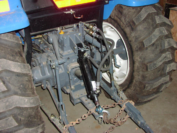

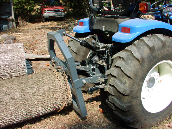

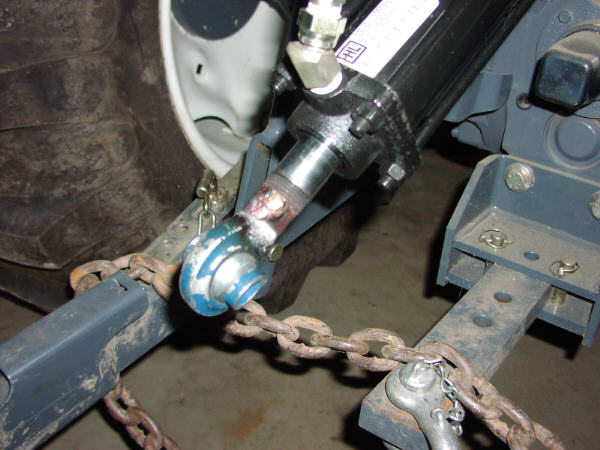

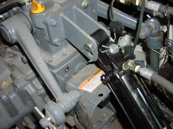

It took a while but I finally finished it. The cylinder and hoses came from a Quality Farm and Country closing sale the link end from my dealer and bought the fittings and couplers new. The block on the tractor end was made by a tool and die freind and the other end welded by a welder friend.Thanks to jinman for the ideas.

Good Job Kevin, congratulations! I don't think there is any handier modification you can do to the tractor. Wait until you use it with a box blade, it's the cat's meow.
Dave
   / Top link #6
Kevin, that is a great job./w3tcompact/icons/grin.gif/w3tcompact/icons/grin.gif/w3tcompact/icons/grin.gif I'm sure it was worth the wait. Now, if you are like me, you'll like it so much you will want a tilt cylinder too. I'm just waiting until my new house is finished before I put two more remotes and a tilt cylinder on mine.
