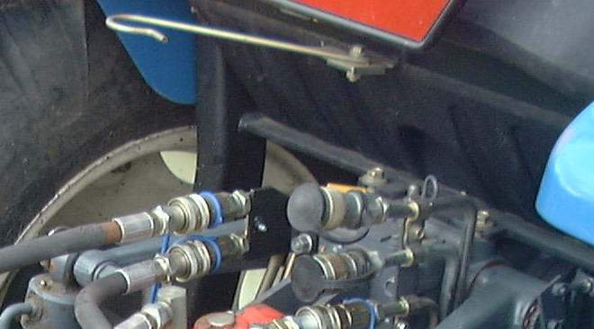

Has anyone made up, or know where I can buy, a top link,hook(bracket)you can store the top link out of the way, til you hook up to another attachment? I hate to leave mine hanging down, banging into everything when I don't have it hooked up. Kubota has them on some of their CUT models. I have a Yanmar YM2500 and could secure the hook to rear of seat.

The factory hook on my kubota is nothing more than a thick heavy duty wire that is bent with a hook shape. No need for something strong, I would just build one.

Here is a photo of the OEM hook on my tractor.

Rubber bungy strap :D
   / top link hook #7
I agree.. bunji cord to the back of the seat or similar item.
soundguy
   / top link hook #8
I use a bungee batween the draft links and around the top link. That keeps all three secure and no rattling.
   / top link hook #9
Hey Jim,
I took a piece of 3" pipe and cut a piece about 2" long. I then put that piece on my bandsaw and cut it in half, to end up with 2 half moon pieces. These pieces fit around the hyd cylinder very nicely. I then welded some tabs on each end of the pipe halves. I made the tabs out of 1/4" x 1" flat bar and drilled 3/8" holes in each tab. Two of the tabs are 1" long for the bottom side of the halves and the other two are 2 1/2" long. I drilled a second set of holes in the tabs that will be used to put a hook through. Then you put the pipe halves around the cylinder, with a piece of tape on the inside of the halves, to snug the fit up, and then bolt the halves together. I attached a piece of 1/4", chain about 10" long, to the back of my seat frame with a bolt and put a hook from a binder strap on the other end. I just lift my cylinder up and put the hook through the upper set of holes. Works great. If I can ever figure out how to post pictures, I will take a few for you. Hope this helps.
