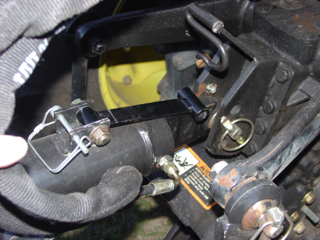

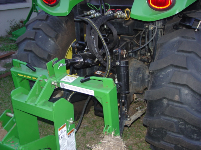

No body can help out? I got the cylinders on but have a few parts left over for the top link I think but not sure how it all buttons up. Got the kit loose with no instructions.

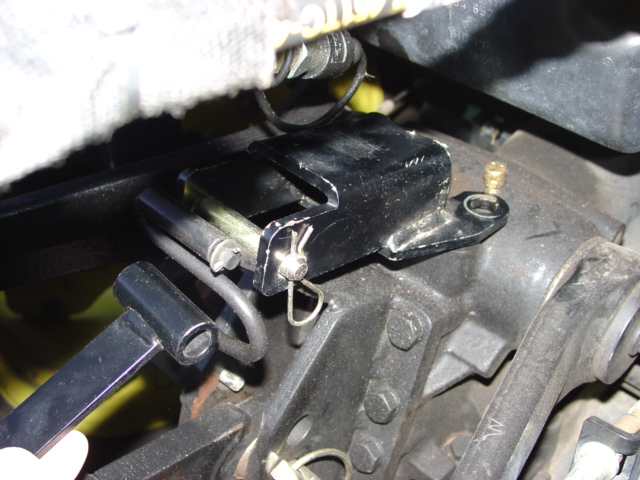

Yeah I did that already and didnt get much help. Here are some pictures. I have this bracket left and I can tell it bolts on top but Im not sure how to hook the top cylinder to it because the origanal top link bracket is the way. The only thing I can think of is to flip the original bracket over. Any ideas?

Maybe a visit to the Deer dealer with photos in hand..... maybe they could explain?
