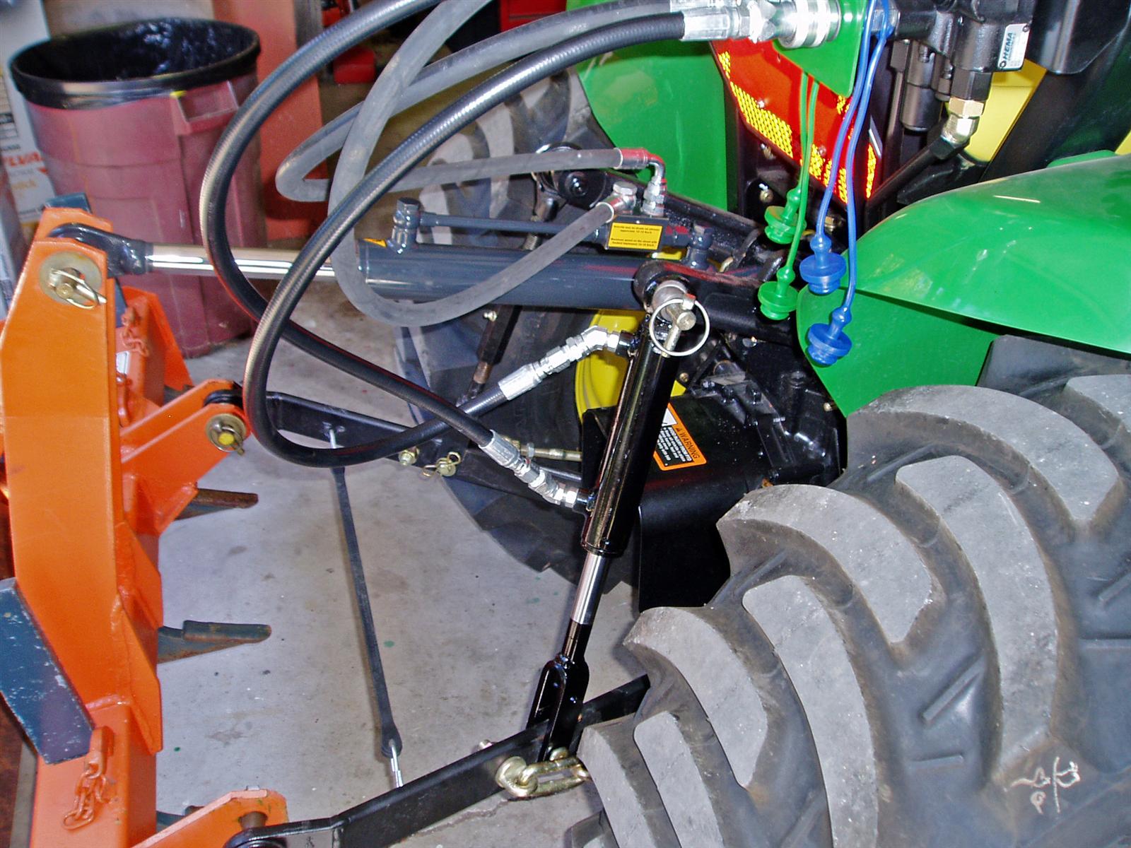

Spent today cutting down the shoulders and re-crowning our 1/4 mile gravel lane using TnT and a box blade. I used the side link a LOT, the top link only a few times (to get the cut depth like I wanted it). I would never own another tractor without both top and tilt.
Once you've paid for dual rear remotes and a top link, adding a side link is easy and no more expensive than a top link. You can buy a side link cylinder ready made with custom clevis already welded on from CCM for about $250, or if you can do basic welding home brew your own with a $90 cylinder from Surplus Center. I did the latter, wasn't all that hard to do, but mine doesn't (yet) have a DPOCV on it like the ones from CCM come with. One of these days I'll get that sorted out.
If you've already blown $900 to have a dealer add dual remotes, seems a shame not to make use that second remote, and having tilt really is a good thing, more useful than you can imagine.
