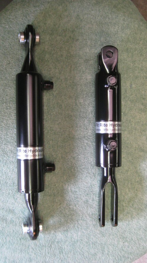

i haven’t posted in a while so update due. About 2 yrs in , 150 hours, 3 regen cycles, lots of mowing, grading, and loader work. No real issues to speak of and really no complaints. Tractor has done all I have asked of it. I don’t really care for what is guess is newer loader operation where it will lift up to a limit then just bypass. I’m used to older tractors with no bypass that would at least try to lift but I assume it is a safety thing and it just is what it is. Well on to the subject. Trying to find at least a tilt set up for box blade. Dealer says cost is around 500 now and big delays from last just like everybody else. I have some hydro experience from the old days and it does end seem to me that it should be that difficult to rig up a couple hoses and short stroke cylinder but I must be missing something. Sure don’t want to damage my tractor but I have 500 foot gravel driveway and a tilt would sure come in handy. Any ideas?

2 1/2" dia cylinders with 1 1/2" dia rods similar to those pictured.
Top link is $345
Side link is $515
Hose kits are $60 each
Flow restrictors and $15 a set.
UPS shipping costs of ????
Current lead times are running at a minimum of 32 weeks.
If you are interested, please fill out the contract page on the Fit Rite Website.
I'm not sure if you will find a side link any where else. :unsure:

I have an LS MT240e so similar to yours. I went with this from Tractor Supply, took about a week and shipped free to the store. No flow restrictors or anything else needed if you already have rear remotes. It even has the double pilot operated check valve.
Prices have gone up in the last year, but still only $300 combined + tax.
