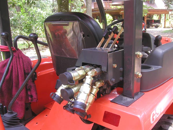

I'm on the market for a T-N-T kit for my L39. The Kubota product (L9554) lists for $750.
Anyone have experience purchasing a less expensive alternative?

We paid $750 for the OEM setup on our L-39.

Thanks for the reply. The three valves (L9553) retail for $1179, so $750 sounds like a good deal. Did you buy them with your machine or afterwards?
The 2 cylinders for the TNT kit (L9554) retail for $750. Do you have this product as well?

We got the rear remotes about 6 months later.
I do not have a TNT on the L39 at the moment, however I do have it on my L-3130 and it is an easy swap over to the L-39 once the BH is removed.
