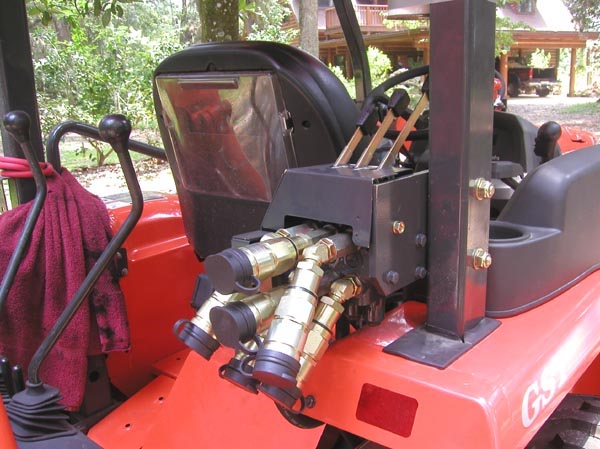

OEM Top and Tilt for my Kubota L39
The most common control I've seen is a single spool control for each of the top and tilt - is there another kind?
The Kubota control seems to have positional control (1,2,3,4....) Kind of like the "draft" control. You want to set it at 3 for this and 4 for that... seems like it's repeatable. I can't seem to figure how that works with regards to the hydraulics - wouldn't there have to some type of limit switch to tell the control how extended the cylinder is? or it just a standard spool control?
(the attached picture is of another users TNT set-up on a L39 - the OEM version - How do the levers work?)

The L=39 does have position control hitch but it doesn't have draft control as standard equipment.
You just have to move the lever to the valve you want to operate.

I answered my own question by spending $1300 and buying the control. Answer: Standard spool valves inside a fancy housing!)
Now I have a second question - Do the TNT cylinders made by/for Kubota for their Top and Tilt kit have check-valves?
