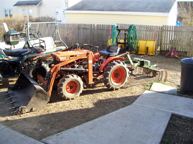

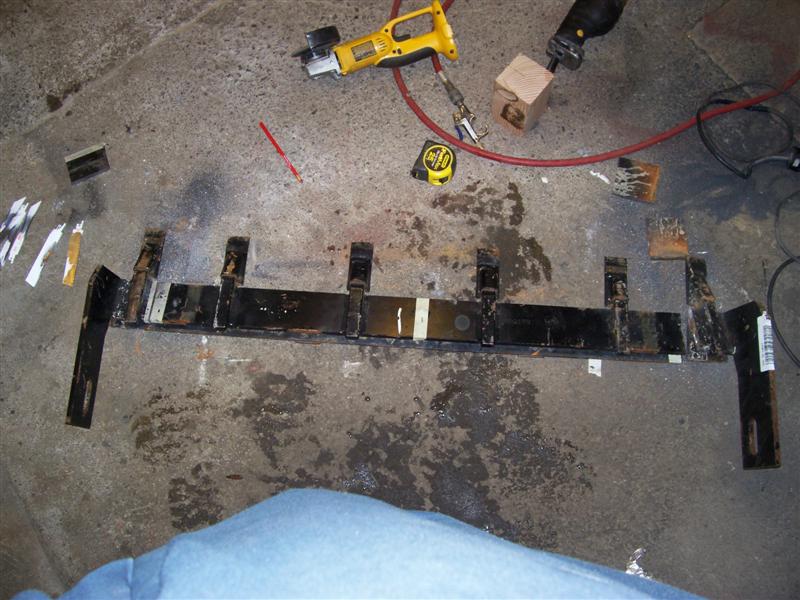

I picked up a tooth bar off ebay for $70 it was a 5ft one i think. I cut it down to 48" and I love it. tractor is up at my camp I can get measurements for you this weekend. Here are 2 pics of it.
