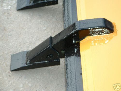

Does anyone have a toothbar on their light materials bucket? If you do, how how has it been working and holding up?
If no one has this arrangement on the L/M bucket, would anybody foresee any significant issues or stresses on the bucket or lift arms if I were to try it?
Thanks for your input.

Just a gut feeling here, but wouldn't your stresses be less with the teeth than if you were to attack the same tasks without?
Really the only place I'd imagine new stress is the cutting edge, but isn't that the same as the rock bucket?

I'd think that adding a toothbar would actually reinforce the bucket, making it less prone to bowing/bending, since you're adding another reinforcing bar across the top of the cutting edge in addition to the one below. Note tha this does NOT apply to the factory's bolt-on individual teeth, which actually weaken the integrity due to the bolt-holes, and does not spread the stress that may be placed on one or two teeth across the entire cutting edge.
However, adding the toothbar will also mean that you're likely to put more stress on it digging. So, it might be a wash... /forums/images/graemlins/tongue.gif

Teeth also make it easier to push into a large pile of material, whether it is dirt, sand or gravel. They concentrate the "cutting force" into a much smaller area, making it easier to push the bucket into the pile.
If you're just scooping up loose material that's spread on the ground, they don't make a significant difference, and they limit your back-blading abilty.

That's what I thought, too. The teeth on the little bucket didn't seem to do much. The teeth from the factory are thick steel with a blunt nose. They helped with filling the bucket with loose rock, but did very little in hard soil. Then someone here, forgive me, I have forgotten who, told me to sharpen the darn things. The difference was increadible.
Think of it this way... all of the force of the tractor dispersed across 48" of steel with a straight edge OR all of the force of the tractor dispersed across 6" of steel(if you have six one inch wide teeth).
Knowing what I know now, I would not buy the teeth from PT and would buy a tooth bar for the small bucket from another vendor. At the least, the first thing I would do if I had the factory teeth is take a grinder to them and sharpen the tips and taper the edges.

I saw all those expensive tooth bars, plus shipping, and thought why not do this. So I went by Bobcat asking about bucket teeth. He says I have some I will let you have at cost, so here is what I did. I tapped seven of them on, and they fit like a glove. Then I welded them in place. If I need to drag flat, I will use the bottom back of the bucket.
