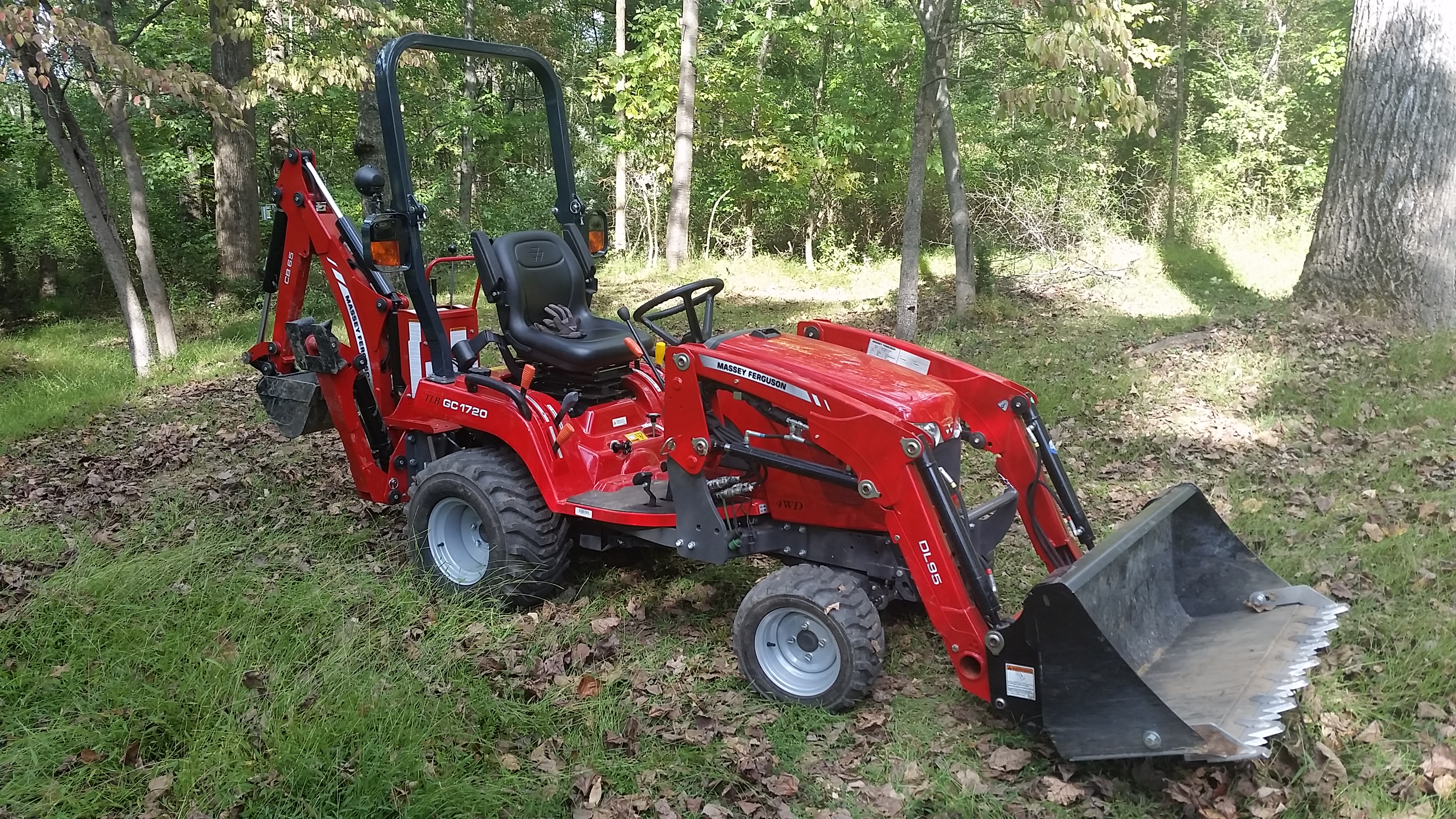

I have the PTB and clamp on titan short forks. The depth of the clamp on these is pushed out a bit with the PTB on. I think the longer forks have a longer clamp and would work fine. Been happy with the PTB so far for breaking up rocky soil which stopped my tractor dead with the straight edge only. The EA looks pretty nice, I'm sure others must have one and could comment.
MFGC1720K.jpgThis is how it looks on my 48" bucket. Easy to measure,drill,install. I might take it off to move my 600 pound bar, but I left it on to move/lift lots of wood rounds and smaller trunks with the short forks.
