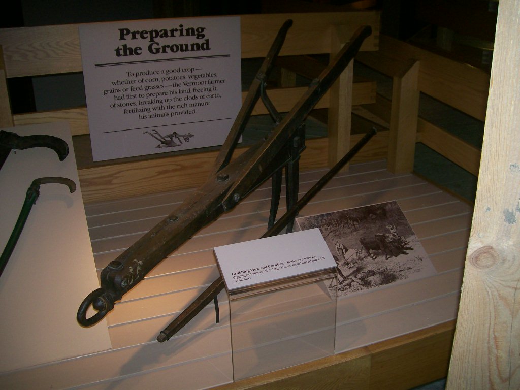

OK, everyone is going to laugh at this, but here are a couple of pictures of what our ancestors used to clear the fields of New England with, using oxen, of course. I liked the idea of the twin blades, somewhat thinner than a subsoiler, and I liked the reach though you wouldn't need to clear the oxen's hooves. With hydraulics, and some thought, it just might be workable.

Would a subsoiler type of plow work? How deep you have to go for the rocks?
   / tooth for uprooting rocks, big rocks #5
I wanted to get a subsoiler, partly for my rocks, but the ones I found were too big, or too small for my use. I did buy a middlebuster, and have used that with some success for rolling out some pretty good sized rocks. Other than the reach from the 3pt hitch, I think a subsoiler would work very well, and leave a minimum impact on the surrounding grass, etc. I bought some steel to make a subsoiler type blade for my middlebuster, and expect that it is going to work pretty well. If anything, I think the angle of the subsoiler blades might be a little closer to 90 degrees from the ground level to work better.
