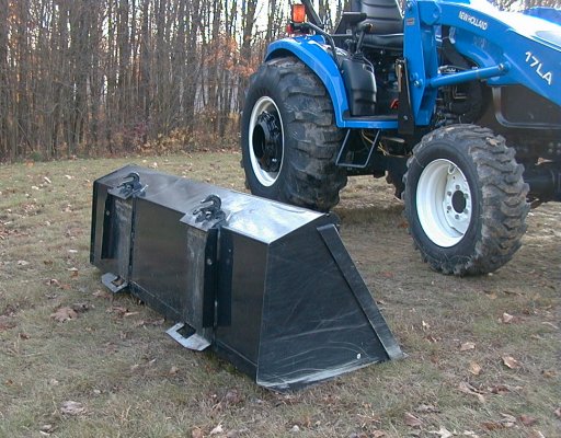

Bird I'm thinking some of the manufacturers are getting smarter. The bucket that came with our New Holland was pre-drilled for a tooth-bar. I'll bet NH isn't the only one following suit........
EDIT: Here's a picture of the new bucket even before we added the tooth-bar.

Mike, I wonder whether the manufacturer did that, or whether the dealer did it. Seem like a good idea anyway.

A lot of dealers are still unaware of toothbars, and as they become familiar, more are adding them in advance from what I've seen lately.
