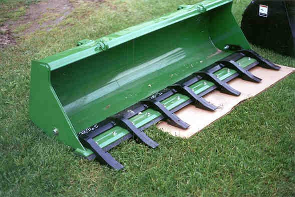

Here's a pic of my FFC extra HD toothbar on my JD HD bucket. This has tremendous digging ability. I'm not at all concerned about these teeth or shanks breaking...they are so massive.

Bob,
I have been looking at these on Carvers site and they specifically state tooth bars don't work on HD buckets with removable/bolt on cutting edges like I have on my B21TLB.
Now I see yours has essentially the same setup as mine. Can you provide some feedback on this and the rough cost? My bucket is the HD 56".
Carl
