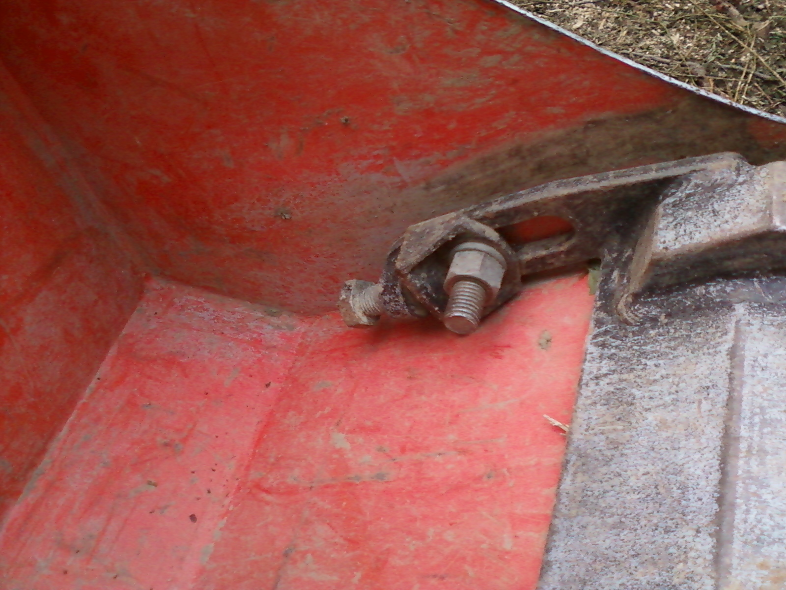

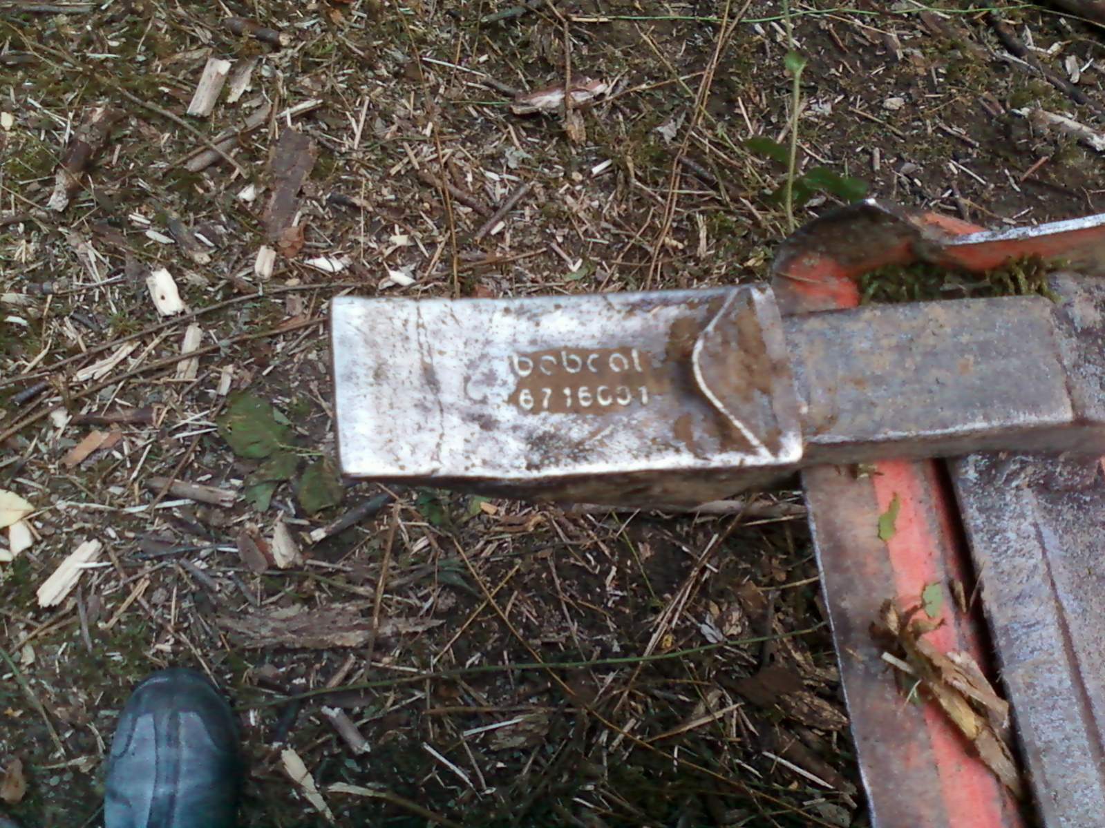

First are shots of the tooth-bar itself. It bolts on from the sides and pulls over the front edge of the FEL. This adds nice traction weight, strength, hardness, and a robust installation surface for the teeth. The teeth are replaceable and are fastened in place with roll pins.

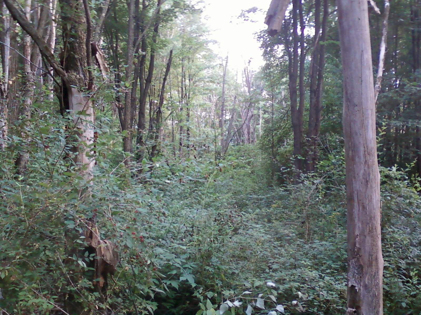

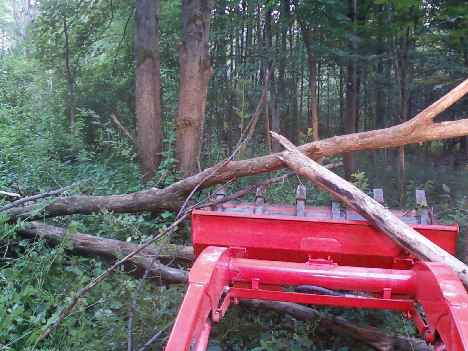

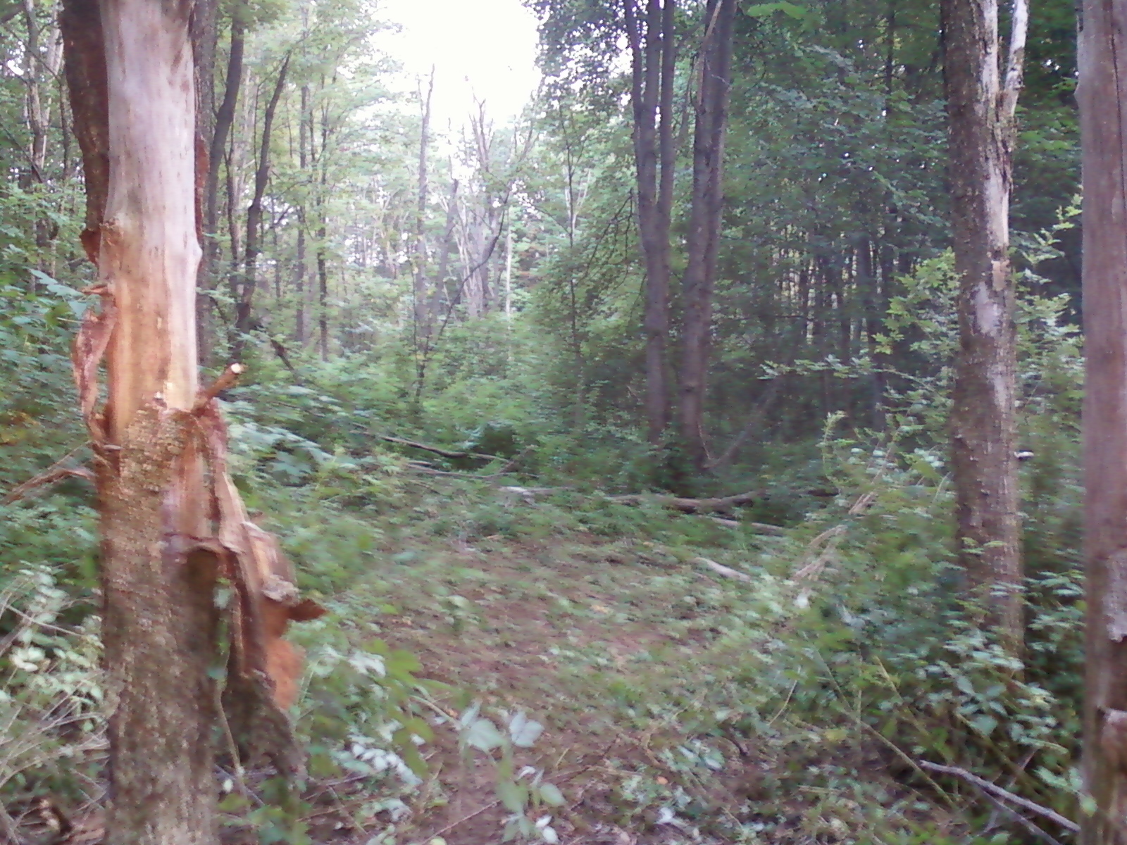

Next shots show basically what I started with and what I did to it with Rex. It took me less than 3 minutes to clear out what you see in the before/after photos. I didn't have any ballast to work with tonight (brush cutter or box grader), but pushing and lifting windfalls is very easy. You get the teeth under the tree, roll the bucket to hang it on the teeth, and lift the tree. It's kind of fun ramming windfalls between healthy trees to split the windfalls into smaller pieces!

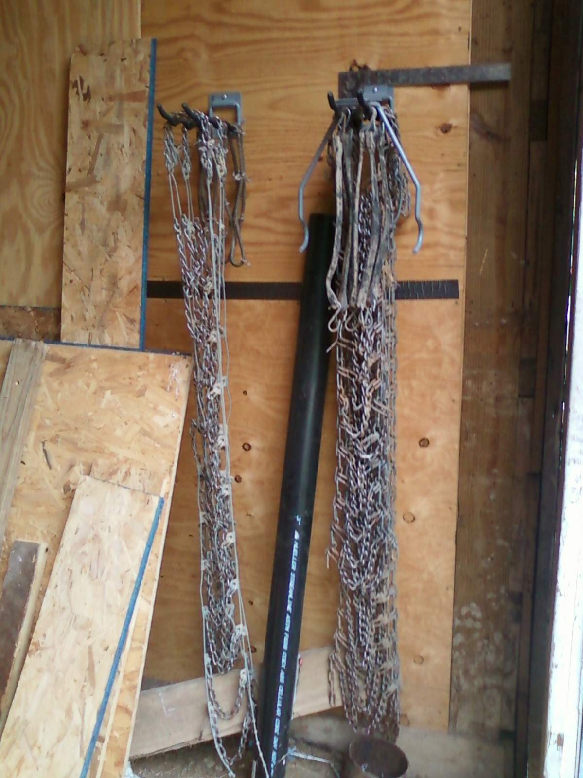

The last photo is my tire-chains-in-waiting. The birds are beginning to flock, and the evenings are getting cooler. It's just a matter of time...

That Bobcat toothbar looks almost identical to the Markham Welding toothbar that I have (Markham Welding sold out to Gator).
I absolutely love mine - it sometimes allows me to do things that I probably shouldn't with a CUT. :)
