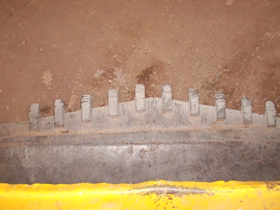

Picture of the teeth I welded to my IH 3444 bucket. I also replaced the cutting edge with some 4340 steel, with a spade nose. Comes in handy sometimes, just can't remove it.

I machined the teeth out of 1020 steel bar stock. Then cut out and machine finished each one. Heated them and bucket to 400 segrees, then welded into place. Afterwards hard faced them with hardfacing rod. Another pic.

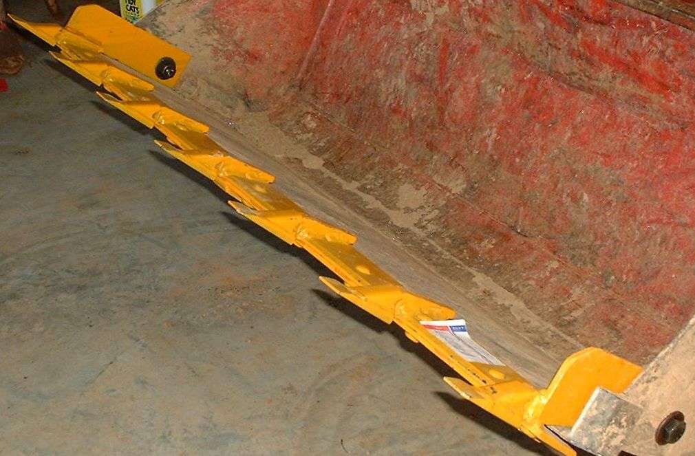

Installed late Friday, played all day Saturday, and it works great. All I had to do was drill two one inch holes, and put the bolts, sleeves, and washers in place. See Attached Picture.
