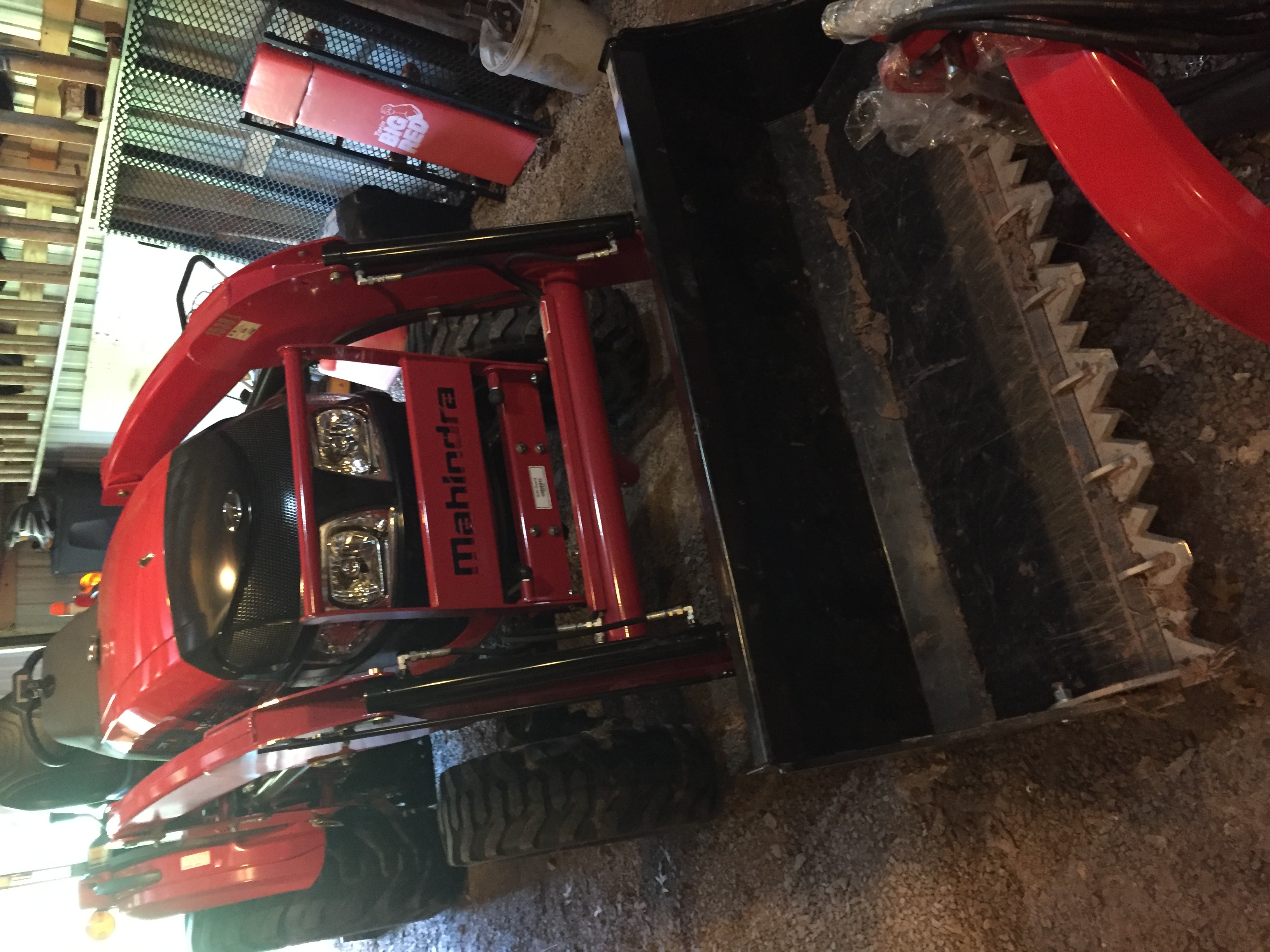

I also own the piranha tooth bar on my 1533 model. Works well on various projects I've undertaken! IMG_5146.JPG
   / Tooth Bar for 1533 #9
I forgot to tell you my bucket measures 56 1/2"! When I ordered mine they had one already left at that length in the shop!
