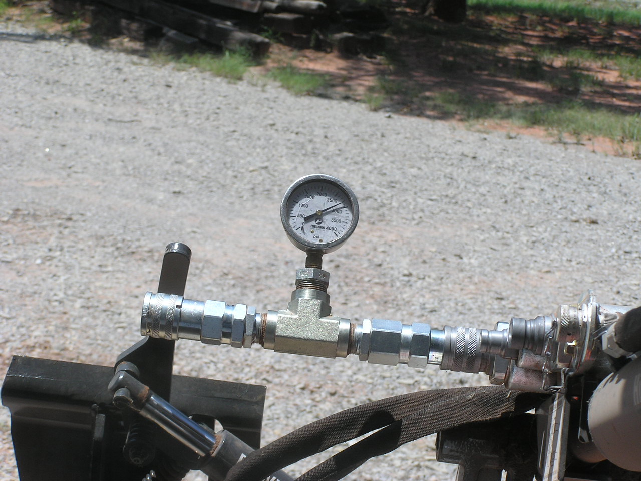

I have a 2010 tool cat 5600 I brought it into the dealer to have him check the Auxiliary hydraulics because my plow was not moving left or right he sent me back a quote to fix the machine for $9500 he had a whole bunch of other stuff listed I only asked him to look at it because my plow was not moving left or right a day later he sent me back a quote to fix the machine for $9500 he Said in the email that it needed 2 spools and 2 coils エ Plus he said there was a gasket in the manifold that needed to be changed and he thought in order to do that he might have to replace the headplus he listed it needed an oil change and hydraulic fluid change that sounds a little bit high to me Everything seems to be running fine with the machine except for the plow stoppedturning left or right my question to this group is Does this sound normal The fact that everything was running OK except for turning left and right with the plow angling and now it needs 2 coils and 2spool valves? Any help would be appreciated

Doesn't sound right to me. Get a 4k or 5k a hydraulic pressure gauge and see if there is pressure at the aux connectors:
Ours shows 3,000 pounds
