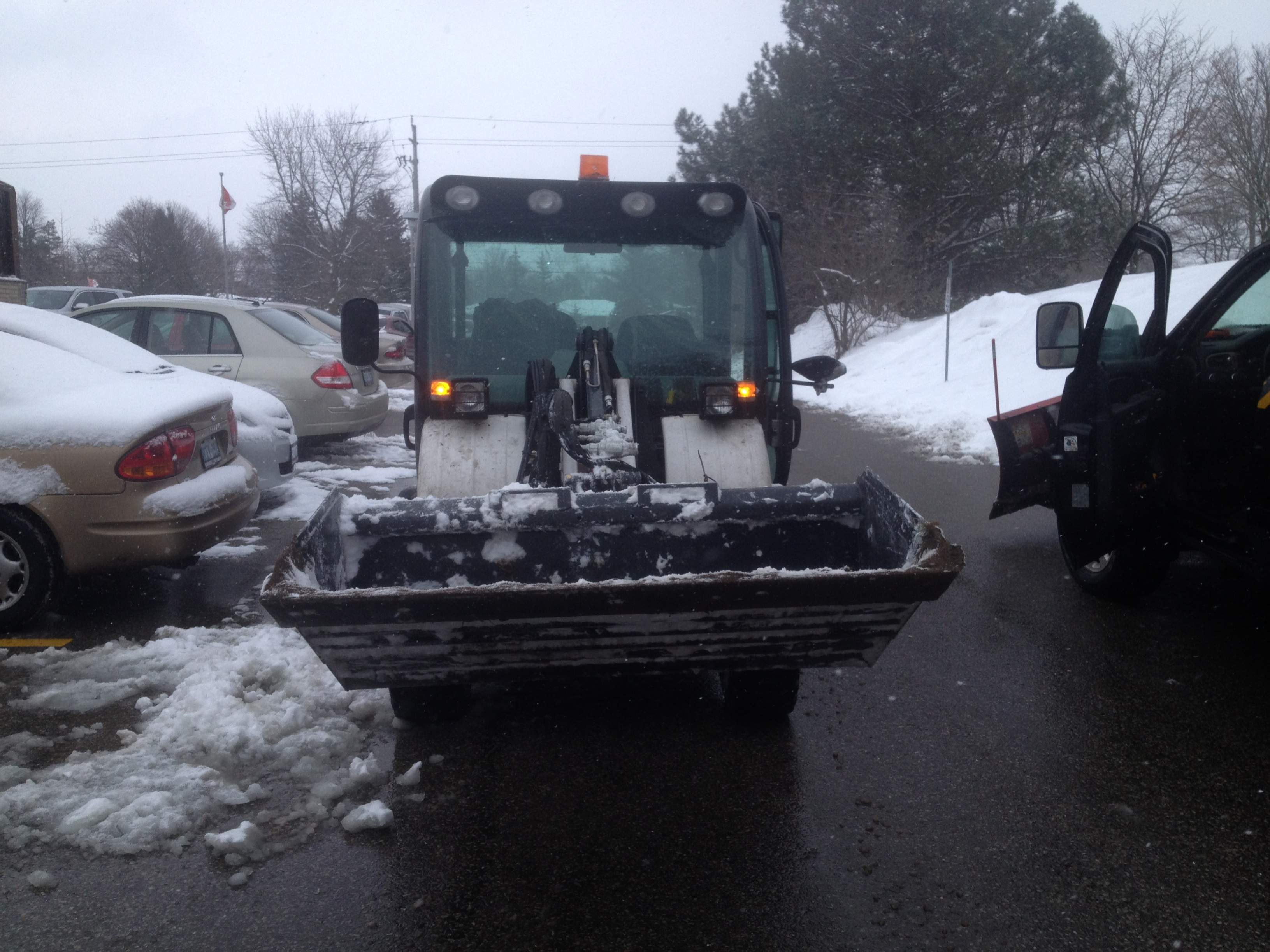

I just got a toolcat 5610. I have used it for a few really light snow falls as well as one 20 + cm snow fall. I have a 8 ft bobcat pusher on the front. I notice while plowing that the pusher was sitting crooked but figured it was because the pusher is on a swivel joint. Well i tried rocking the pusher to see it would become level and that didnt work and i also checked if there was snow or some **** packed in there causing it to sit crooked. But there was none. So i dropped the pusher to see what was up and sure enough the whole front loader was crooked. I have not ran into anything that would cause the loader to bend. I am thinking that its possibly becasue that pusher weighs so god **** much and running down the road with it bouncing up and down has caused it to bend? Anyone agree.

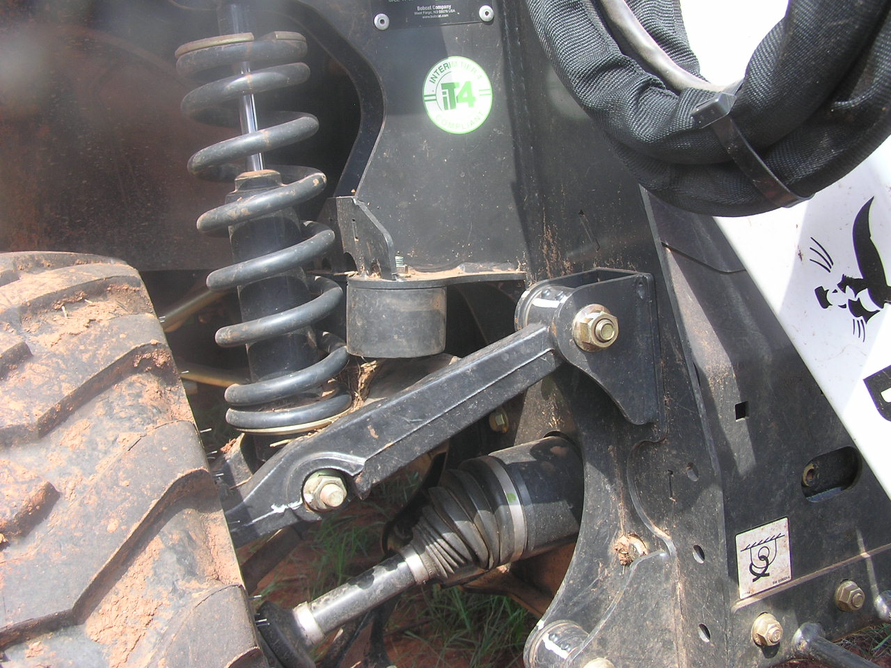

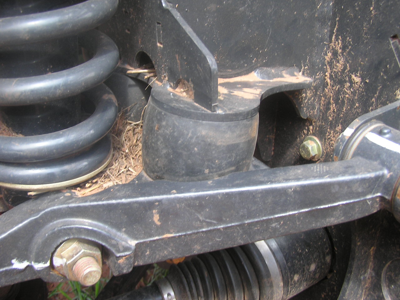

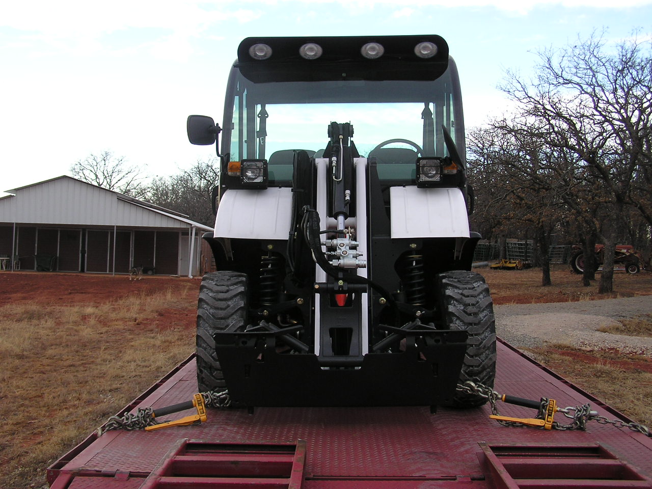

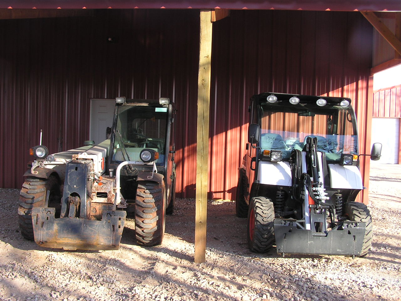

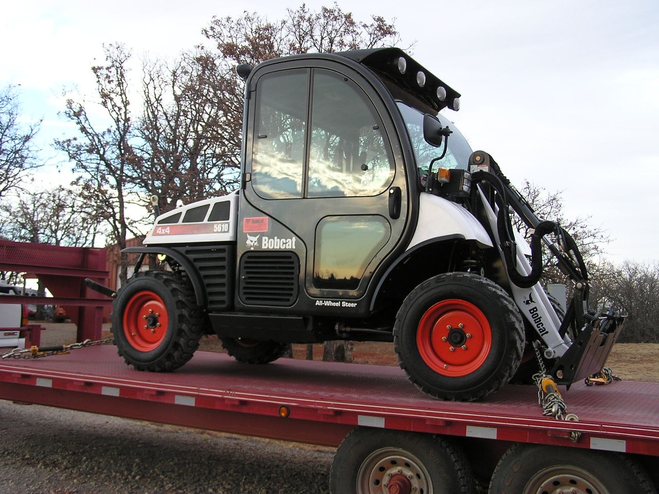

F series rubber frame stop, front wheels off of the ground.

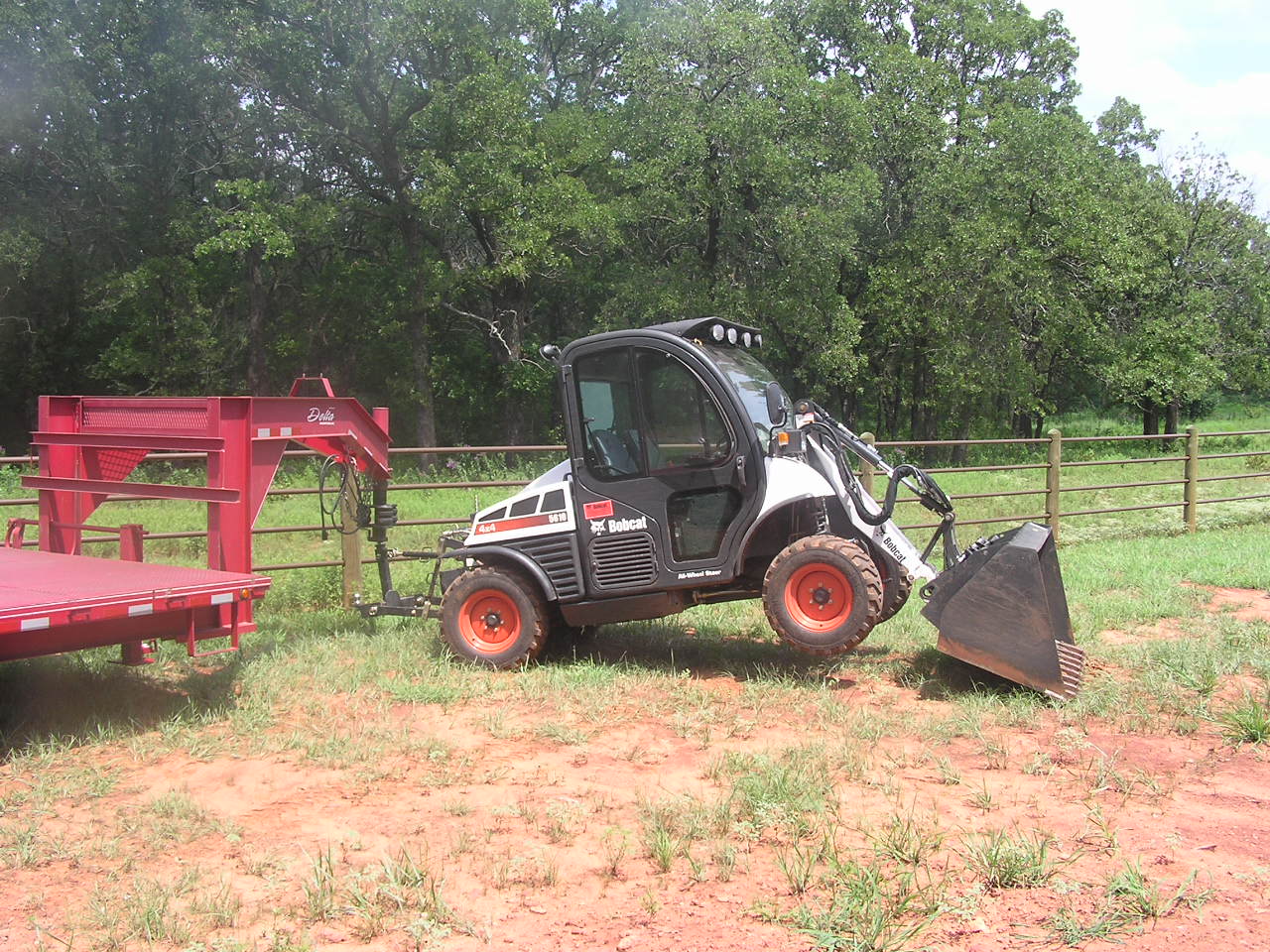

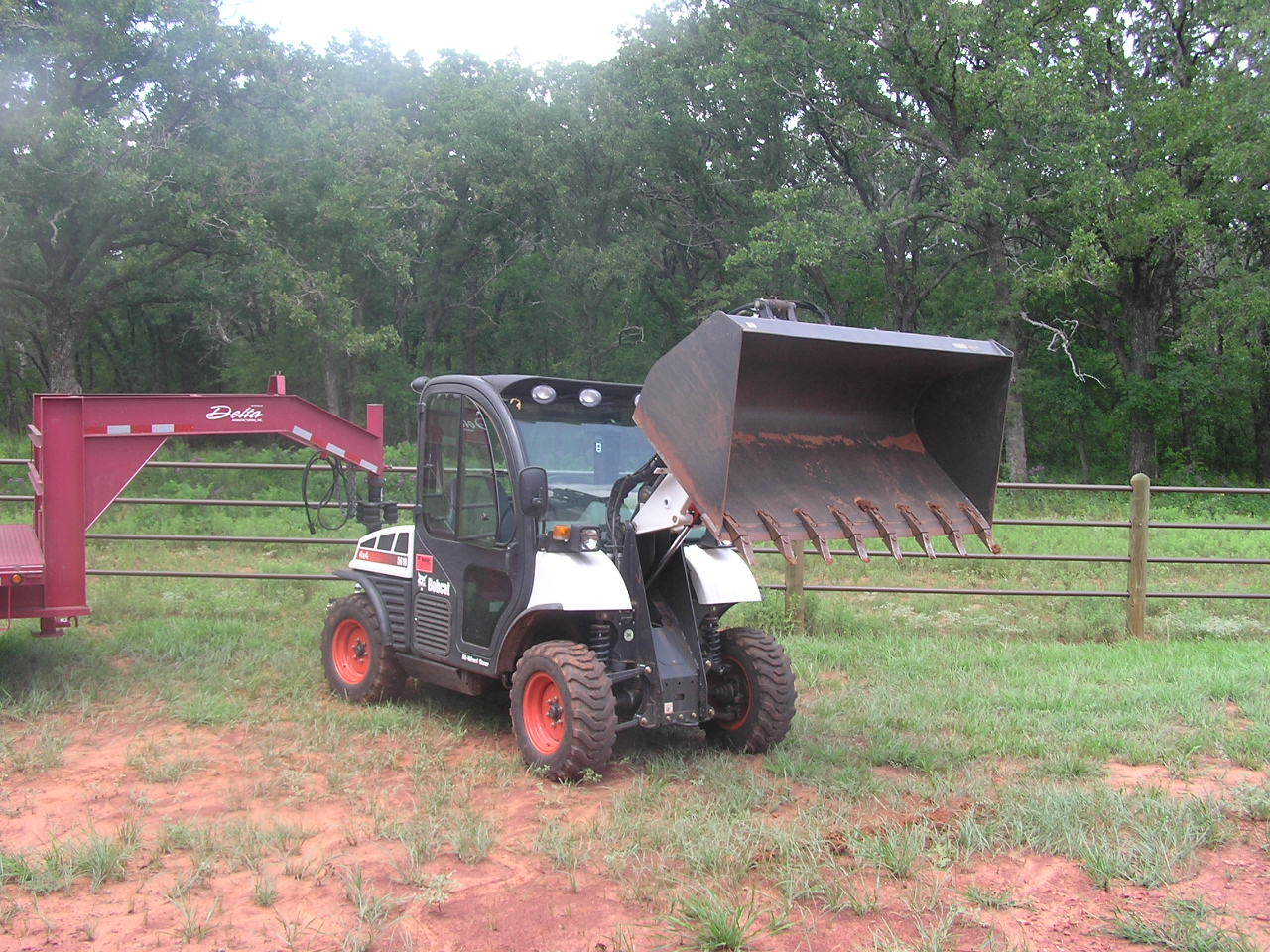

With the 800 pound Versahandler bucket raised.
If one of the rubber "hockey pucks" is missing, it will sag on that side.

haha no insult taken but its actually broken.
   / Toolcat With Bent Lift Arm
Turns out loader arms are cracked in various spots. also frame where loader arms attach to is slightly twisted. DO NOT USE A SNOW PUSHER ON THIS MACHINE! blades are one thing but a box pusher is just too much for it and destroys it!.
Bobcat wont cover it either. GOtta get a guy to do some custom fabing on them to not only fix them but make them bullet proof. going to weld quarter inch plate along the top and bottom of lift arms to make a box out of the loader arms rather then two seperate arms so they are tough. also the welds on the frame where the loader arms mount to are going to be ground off and a thicker weld applied for much more strenght. Bobcat should have thought of this in the fist place instead of putting toothpicks on the front!

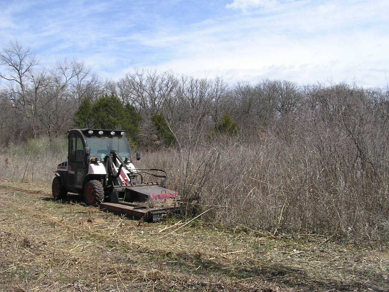

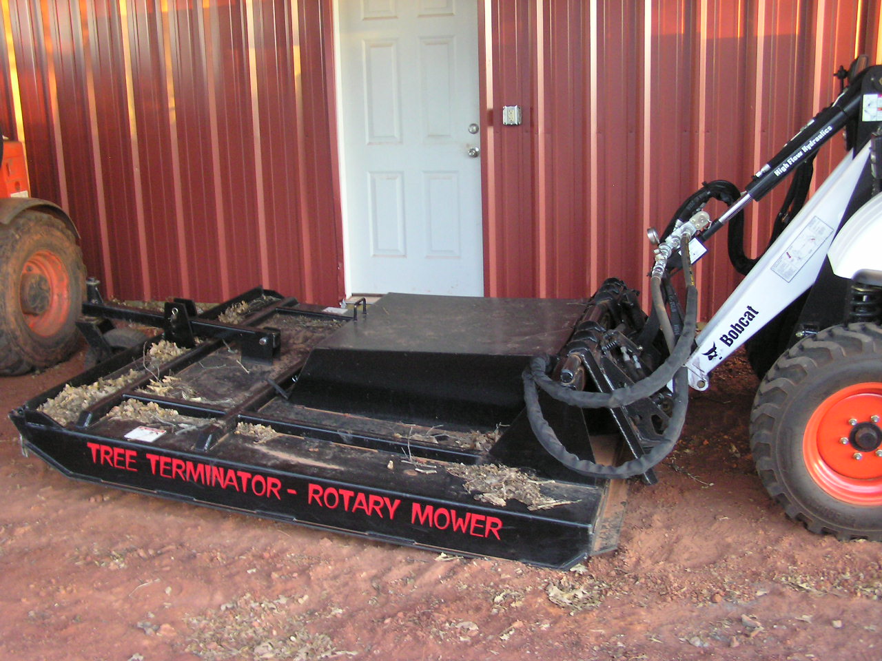

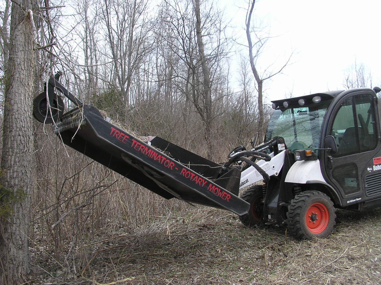

This brush hog weighs about 1800 pounds.
