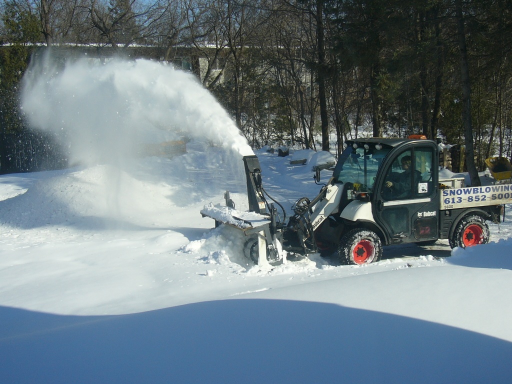

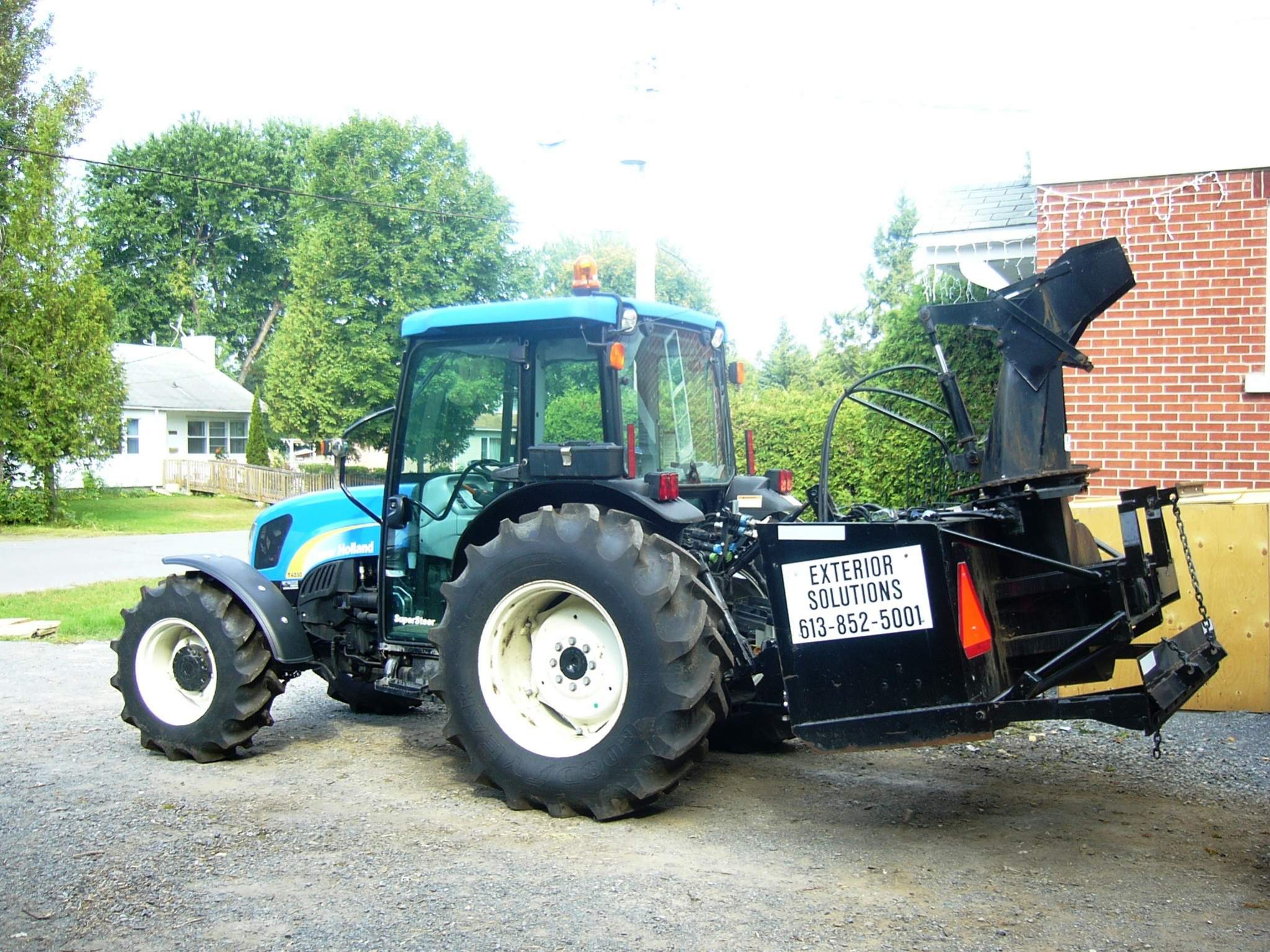

   / Toolcat Snow Removal #8
My toolcat (B series, low flow, 6' blower) would average 15-20 drives per hour. (a mix of single and doubles anywhere from 2 to 6 cars long)
It is not nearly as fast as my New Holland T4040 with pull type blower. It will do 20-30 drives per hour in much deeper snow. Plus, they go 40 kph instead of 30 on the tc.

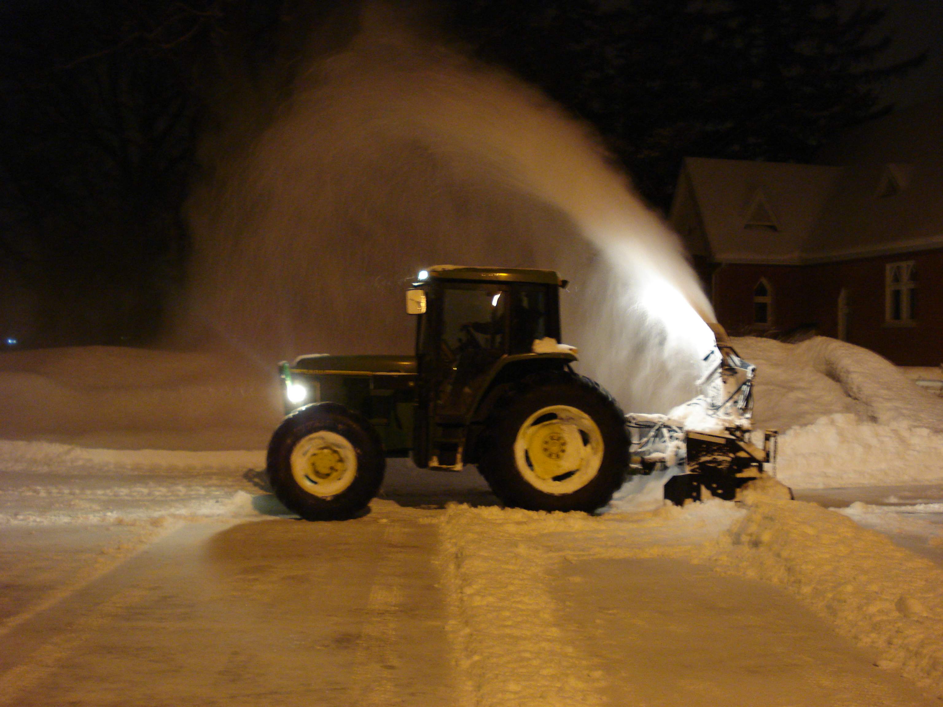

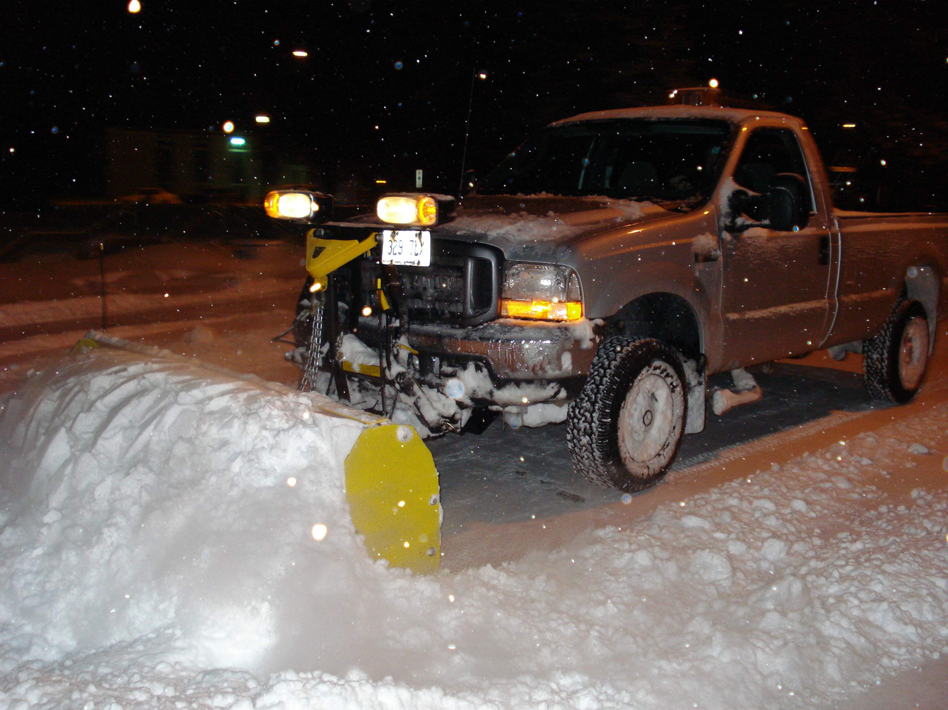

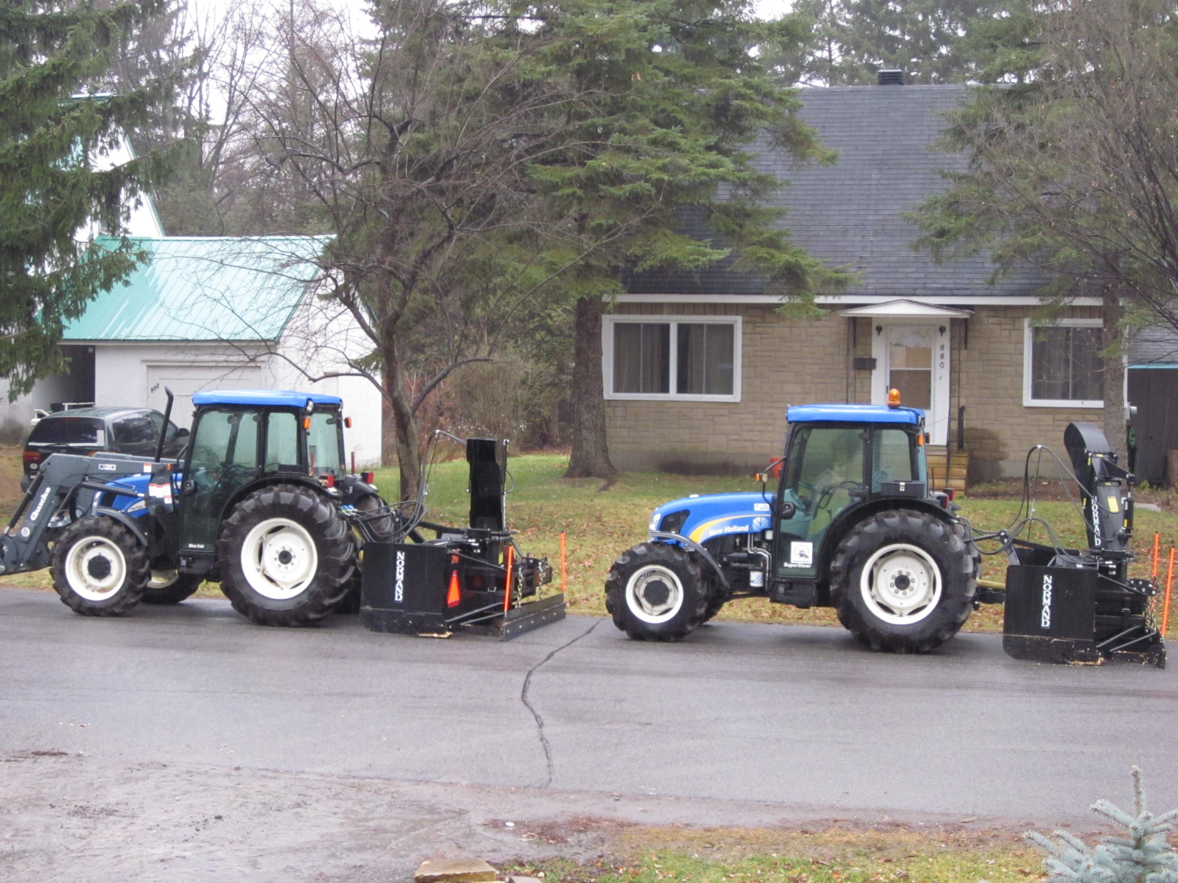

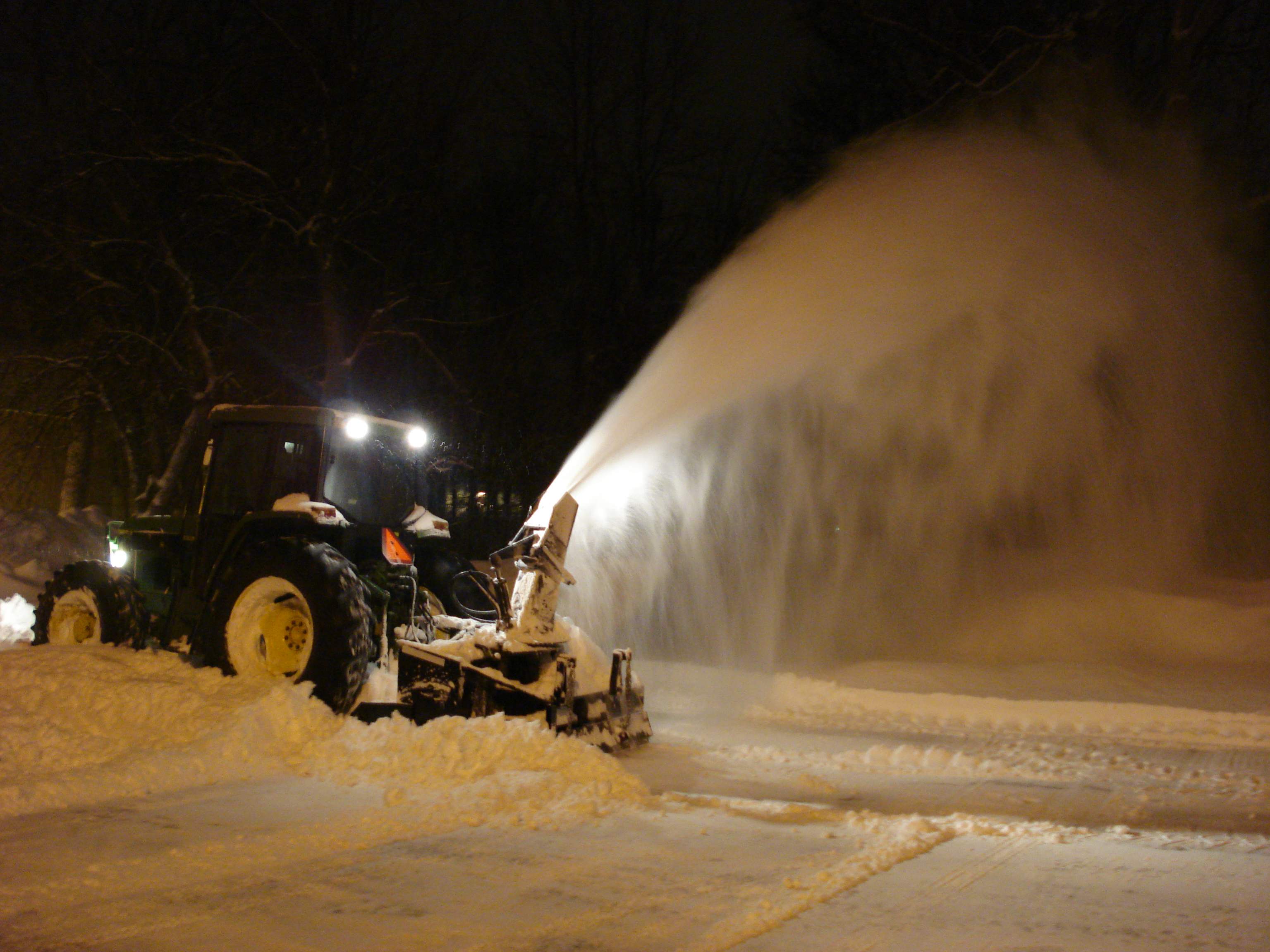

   / Toolcat Snow Removal #10
Thanks Dick. Here are a few more for you.
Those back drag blades are pretty common around here. They allow us to get as close as possible to the garage door when clearing the snow. They can either hang from chains or be controlled with hydraulic cylinders. They come standard with the blowers.
