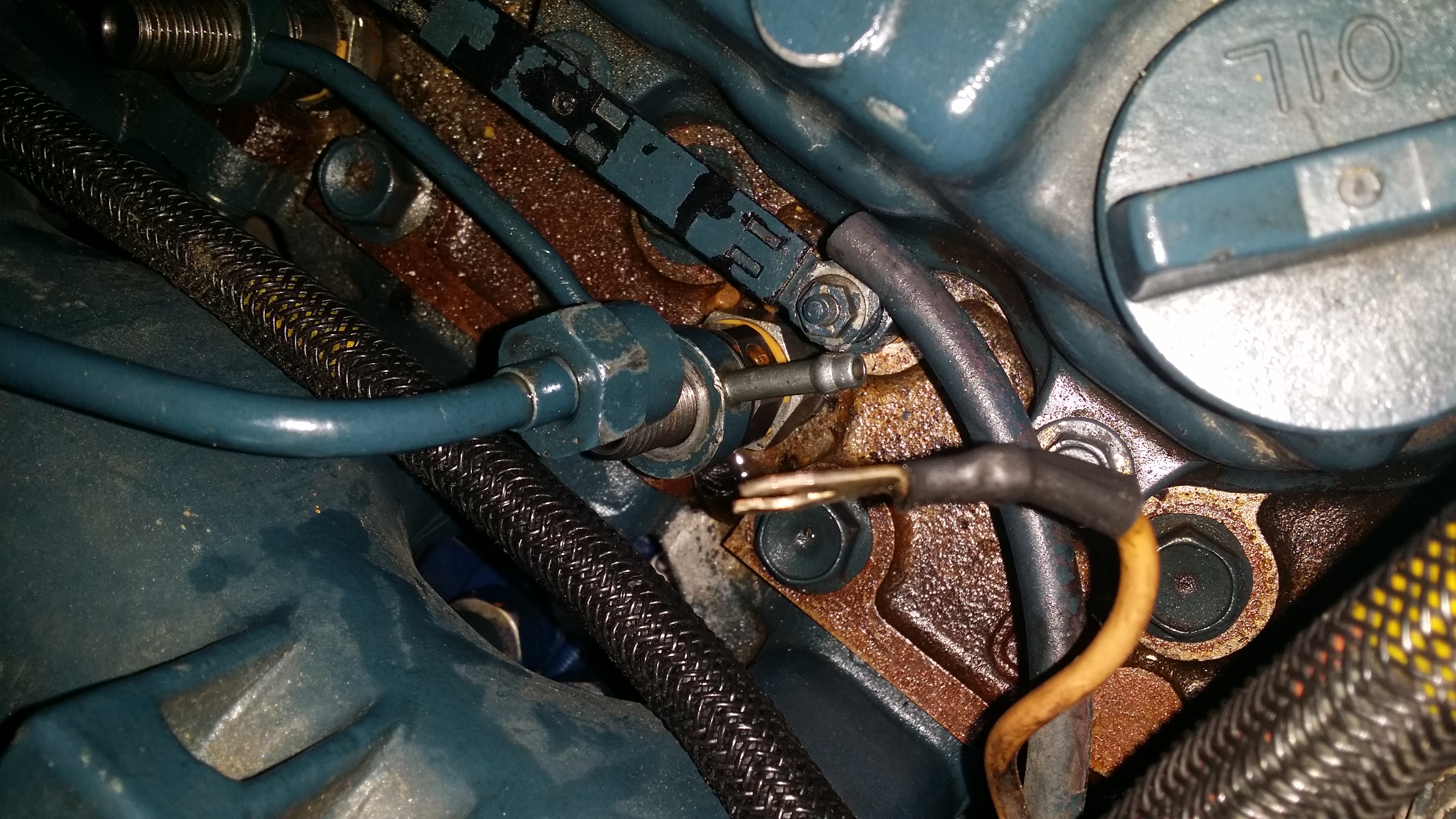

I almost have this thing back together and running; well, it runs but what am I doing wrong here? That return line can't be installed any other way and it's hitting the glowplug. Please help. Rest of the story to follow.

Not sure, but looks like injector should be rotated 180 so return line rubber hose is located at 4 o'clock position.
   / Toolcat series A - please help with fuel line question
timm9 - Yes, I believe so.
SSdoxie -That's a hardline on top of the injector, it can't rotate.
I ended up installing the rubber fuel line and then the wire for the glow plugs on top of it. The wire connector prevents the nut from piercing the rubber fuel line.
